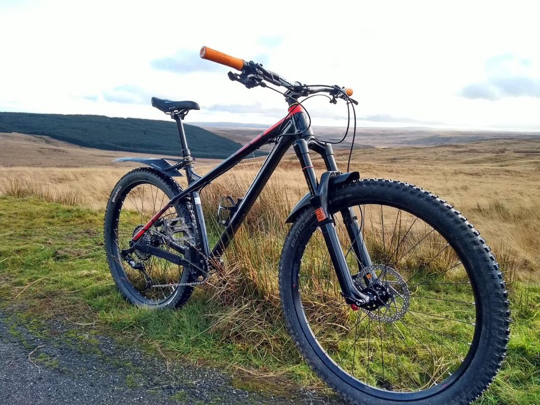

I think ht2 cranks have more side to side adjustability than gxp- but I think you’re going to struggle with both the non boost element and a 34t. Vitus list the max chainring size as 32t - there’s no way I’m getting a 34t boost spacer chainring on mine with that spacing. Maybe with a 0mm offset 34t it may fit but still tight I reckon.
Posted : 14/11/2018 2:17 pm
Posts: 10282
Yes the grass is a bit shoddy - we’re having an extension and it has builders smashing over it all day.
And yes my tyre brands don’t match / logos and valves aren’t aligned.
And I haven’t quite finished the build - I need to finish the gears and trim the derailleur cable, fit a new front caliper adapter (when it arrives) and clip in the front hose to the fork guide properly. Other than that, plus putting a longer airshaft in the fork (taking it from 130 to 140mm) it’s nearly perfect for me!
Posted : 15/11/2018 10:39 am
Posts: 10282
Spec is Pike RCs 130mm / Dt Swiss E1900 wheels / Sram GX 11 speed (10-42 cassette) / truvativ stylo gxp crank 32t nw chainring / magic Mary and dhr2 tyres / 50mm stem / 780mm bars / Guide R brakes /  200 & 160mm centreline rotors. Also a retro rsp dropper - when I have some spare cash I’ll probably swap it for a brand x ascend with internal routing.
Posted : 15/11/2018 10:46 am

Guys, I'm running this frame and love it.
My only problem which is probably down to me is the gear cable routing.
I'm on my 3rd gear cable now (inner and outer), and been as I use it in the winter slop thought my poor shifting was down to mud in the cables.
However, I've recently fitted a fully sealed fibrax kit that has barely improved it. I'm running slx 11-46 set up, changes up the block fine. Changes down go smaller cogs are a PITA. Mainly the top 3 and then it's ok.
I've tried having the cable nearest the rear mech longer so it's at less of an angle entering the mech, tried it shorter, but now I'm totally stuck. I have got it crossing from one side of the frame to the other under the top tube, but been as the cable is sleeved I didn't think that mattered.
Any help please it's driving me mad
Posted : 07/12/2018 9:11 pm
Posts: 10282
I think mine crosses from one side to the other too - the dropper is using the closest one to the mech side at the moment (until I get Roy d to but I g a stealth dropper).
My gears shift perfectly - so light it’s untrue. But I’m running sram rather than Shimano so I can’t really comment on the length of the final stretch of cable from the frame to the mech. Mines pretty short and straight which seems the cable entering nice and smoothly into the rear mech. If you move the cable up and down through the cables without being attached to the mech does it feel smooth and easy?
If it does then maybe something b screw related isn’t quite right?
Posted : 07/12/2018 9:25 pm
Thanks alot Joe.
You were bang on! B tension screw wasn't quite set right, and also too much tension on the slx clutch.
It's changing like perfection now in the work stand, buttery smooth. Let's hope it stays somewhere near in the slop!
Cheers mate
Posted : 07/12/2018 11:00 pm
