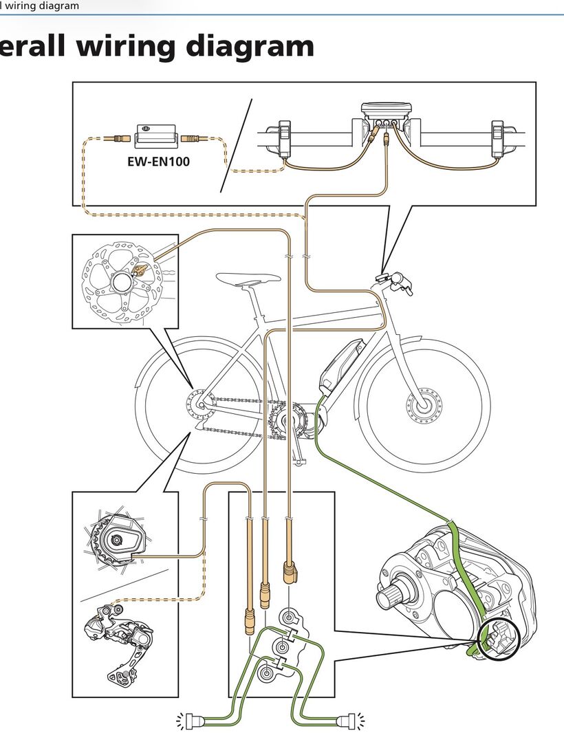

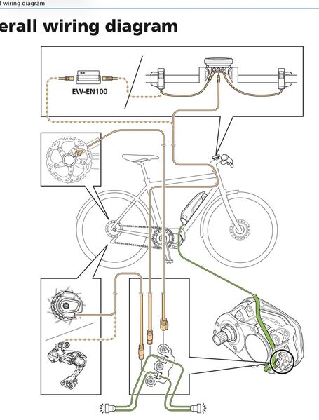

The last job is connecting the screen and front light. The front light looks easy enough it’s 2 wires with spade connectors

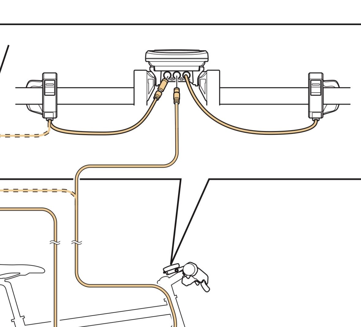

 The assist adjust and wire from the motor appear identical and there are 2 ports in the screen. I found this document online to help
It suggests the power assist controller goes into the port nearest the stem and the wire from the motor the next port. The third connector is i think di2 so i only have 2 ports.
Does this sound correct?
These presumably digital signals? So fire won’t result from an incorrect connection? Infact does the connection order matter?
Posted : 28/04/2026 7:43 pm
Posts: 3864
Doesn’t matter which ports you use, just make sure you leave a blank in the unused port.
Posted : 29/04/2026 10:47 am
Posts: 10079
Thanks that makes sense. It has blanks in the 2 ports i won’t use
