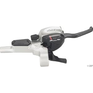

Posts: 1182
which levers are they?
Posted : 18/05/2010 10:32 am
These ones:
Posted : 18/05/2010 10:35 am
