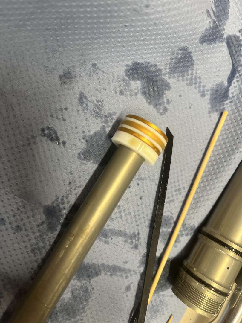

I removed a volume spacer from the 36 that came on my Privateer and from the 38 which is on my Airdrop. It makes a huge difference and the new versions don't come with it fitted at all.
The increased volume make the fork much more eager to use that first part of the travel. Mine isn't Lyrik plush off the top but it's far superior everywhere else.
I can't remember what tools I used but it'll be on YouTube. It's fairly simple to remove the air spring.
The hardest thing for me both times was actually removing the tiny plastic spacer. It's not fixed but it's slathered in grease and held in by suction. It took a long time to make it drop out. You might need a collection of long, pointy things to wiggle it around.

Posts: 4370
Easy job apart from actually getting the thing out, as sharkattack said!
It’s easy when you know how though… I had a google and found a suggestion to blast the air compressor down the side which worked straight away.
I’ll have a ride this week and see if things are better.

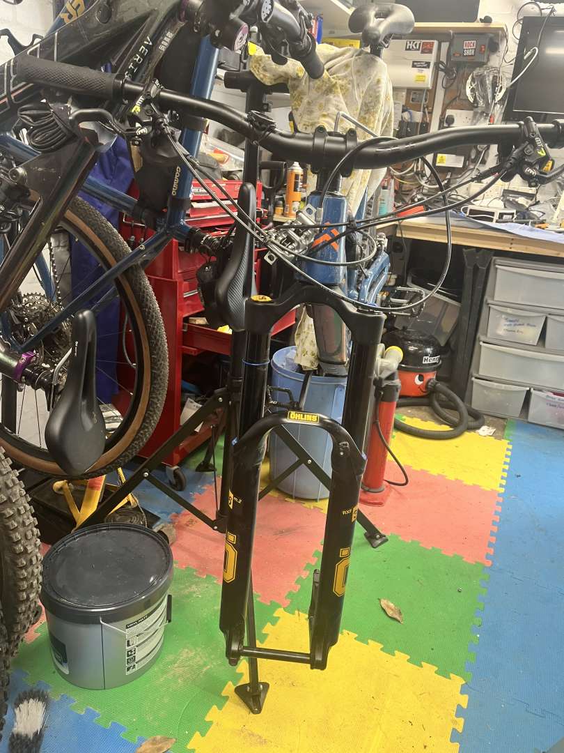

Posts: 4370
So I had a ride on it yesterday, without the negative air spacer & had a play about with pressure.
It's ended up feeling much better than it was, I could happily hold on without it killing my arms.
I've got slightly less pressure in the main chamber than I originally had and slightly under the recommended for my weight, the ramp up is at about the recommended.
I might still get the damper tuned, I've been in touch with J-Tech and it's "only" £50 if you do it with the service - they reckon it should make a decent difference.
They also suggested the Smashpot coil - I am tempted but not sure I want to add 500g to the fork and remove £340 from my bank.
