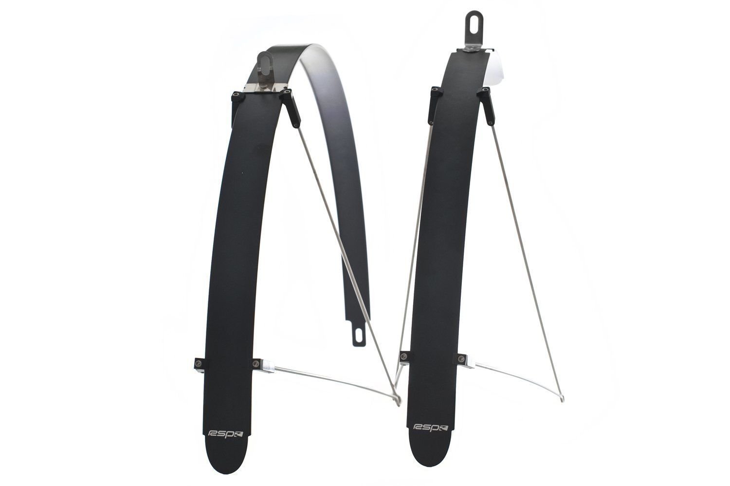

I was looking for some too and saw these on the Merlin bikes, but they don't seem to sell them on their own
[url= http://www.merlincycles.com/merlin-x20-105-11-speed-alloy-cx-bike-commuter-model-75206.html ]http://www.merlincycles.com/merlin-x20-105-11-speed-alloy-cx-bike-commuter-model-75206.html[/url]
Or possibly these?
http://www.amazon.co.uk/Raceplate-Alloy-Length-Mudguard-Fender/dp/B00W3YR6H6/ref=sr_1_1?ie=UTF8&qid=1441294436&sr=8-1&keywords=rsp+mudguards
