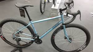

I think the Vagabond prototype had exactly what you are after?
[img] https://encrypted-tbn2.gstatic.com/images?q=tbn:ANd9GcRgcT4zCiSrp-N2gVHXlvTjbWo_MqpKxMquYqi3CAG4rzlXr_h8Ww [/img]
Posted : 12/07/2016 7:51 am
thats the exact picture i saw
looks so much nicer, no? i guess the only visual thing would be the colour difference, but they are pretty close

Lug-crown, curve blade 'trad' style forks and disc brakes are an odd mix. You get the looks of an old fork but not the flex, by the time the blades can handle the disc brake forces/tests. The unicrown they used is a better solution imo.
The Salsa fork would need to be very close in length (AC Axle Crown or fork height, similar dimensions), the offset can vary the handling for better or worse but ime length changes rarely do a rigid or road bike any good as it affects the entire geometry (inc HA / Head Angle). Offset changes just affect the steering response.
No, I think it looks terrible. Very curved skinny forks just look wrong IMO. Much better as it comes as standard... again IMO.
