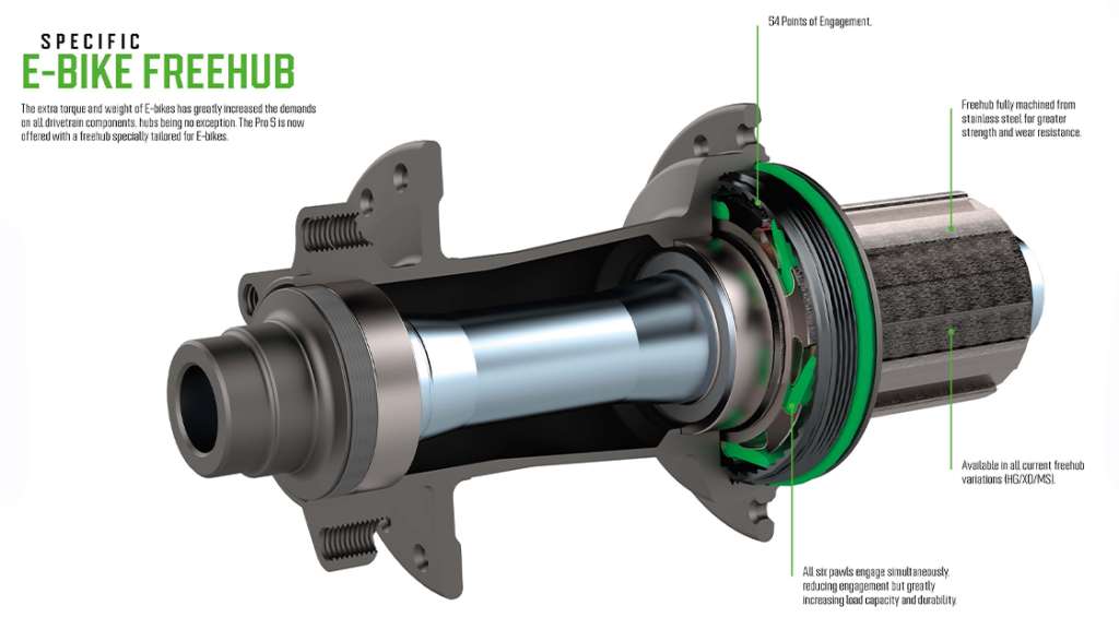

HG.
I don't get 12 speed at all on ebikes, but as you said you can still get strong 12 speed cassettes for HG.... but also 11 speed and 10 speed.
And while you're at it, get an ebike ready HG freehub. They're just tougher, nothing different about the fit. Hope offer that option for pro5... with pawl alignment that means more pawls engage at once. It'll last longer. Don't bother with the lighter normal pro5 freehub body if buying new.
e-bike

And while you’re at it, get an ebike ready HG freehub.
Would be ideal, but its not happening. Making use of the wiggle/crc deal for a fortus 35 pro5 which is £216. Im never going to get the ebike model for that and the standard one will be more than fine for my pottering.

Posts: 31786
Well, one easy thing you can do if getting the standard freehub from old stock @dyna-ti ... check the pawls... if they're the ones with the hole in the middle... swap them for the solid ones that come in the ebike friendly freehub (and newer stock of the standard freehub).
