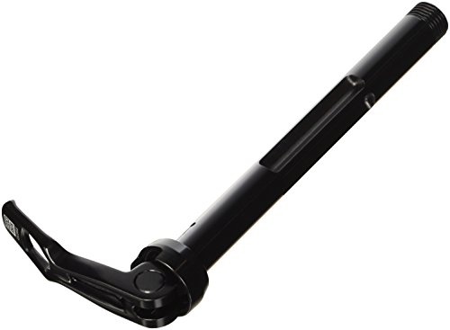

Posts: 18159
it sounds like the OP is describing a previous generation one? Which were very simple and very durable, and lighter than most of the competition, just not 100% foolproof.
I assumed the op is talking about this one?
This above is the shit one imho.
The newer one (I have it on my pikes) seems a lot, lot better but costs fifty odd quid!

Posts: 66087
kayak23 - Member
Yup, me too. Used that method (different variants) on both my bikes for about 6 years without any issues. It just needs to be operated correctly. I did knock the end off an older version on my lyriks, the first gen axle was quite sticky-outy but they revised that out.
I bust the one in my new Pikes after a few months. TBH, may have been a little overtightened but it wasn't gorilla'd (I'm a 10 stone weakling, there's a limit to how overtight it could be!) Not much metal in the bit that broke.
Posted : 27/12/2016 12:44 am
Old version was known for snapping the notch bits off I believe, though seems to depend how heavy handed you are. As said, it's the lever that locks it tight, but can slacken and you need to adjust with an allen key. Tightening via the notch can take up the slack but if it's too slack you risk snapping it. Do up allen key first and lock lever.
