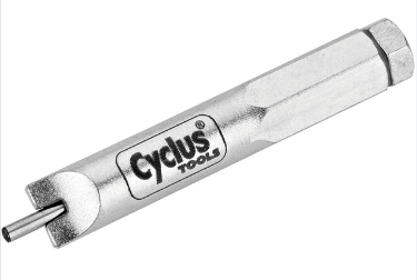

Posts: 66087
I've got the Wheelpro book but the only bit I ever actually use is the lacing guide, and you get get that easily enough for free elsewhere. For me it's always do it in the frame with zip ties, works a charm. I'm a firm believer in buying the right tool for the job but I just don't think a wheel stand is really even that useful, not for a diyer.

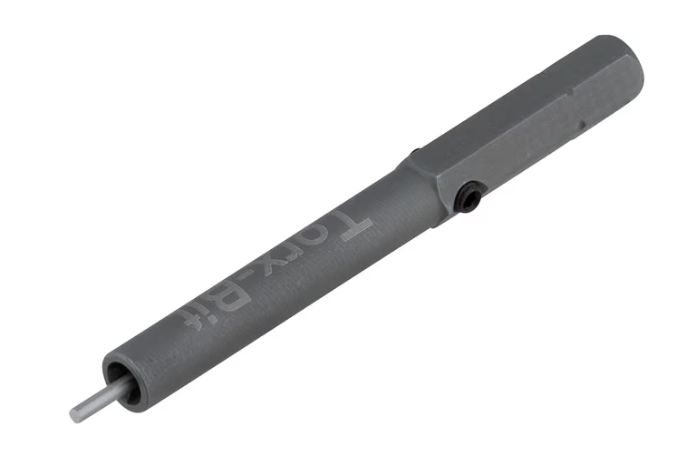

But, one tool that I would recommend, is one of these or something like it.
https://www.spokesfromryan.com/product/bsc-tools-sb-1-adjustable-spoke-nipple-driver/
I'm sure I saw a cheaper version recently but can't find a link now, I have a Cyclus one which was a wee bit more expensive but does the exact same job. Absolutely love it, will never build another wheel without it if I can avoid it. It's depth-setting-you can spin the nipple on with a drill or screwdriver, and it cams out when you reach the preset depth. Means that every spoke and nipple starts out exactly the same. You can actually use just this to build a usable wheel- not a good wheel, but usable, and better than many.
But mostly what it does is get you pretty close as your start point, and then it's really just finetuning.
(oh yeah, note that you can't use them with squorx or similar. But pretty much all alternative spoke nipples were designed to work better with wheel building machines, not for the actual wheel owner's benefit, so I just don't use 'em)

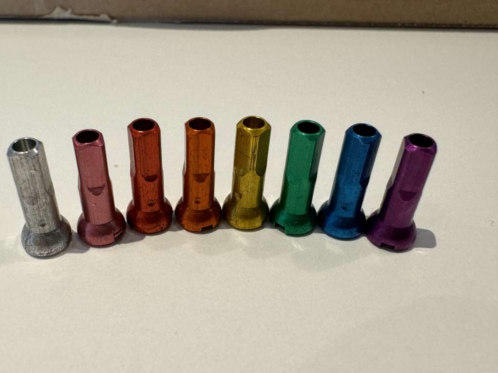

Posts: 138
Squorx brass nipples are just awesome - I build wheels professionally and I won't use anything else anymore. The DT tool for Squorx nipples is also not expensive - https://www.bike-components.de/en/DT-Swiss/Torx-Spoke-Wrench-for-Squorx-Pro-Head-Nipples-p40736/
The best regular nipple wrenches imo are https://uniortools.com/eng/product/1630-2A-spoke-wrench?fromcat=940568#44695
Very firm fit, will not round nipples and can be used to build BMX wheels or high spoke count wheels where a regular nipple wrench will not fit between spokes. Park tool nipple wrenches round nipples really easily and should not be used when the tension is high.

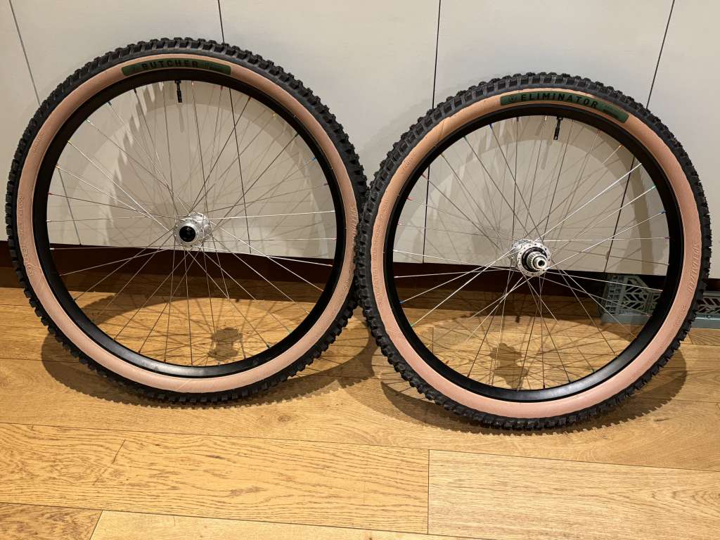

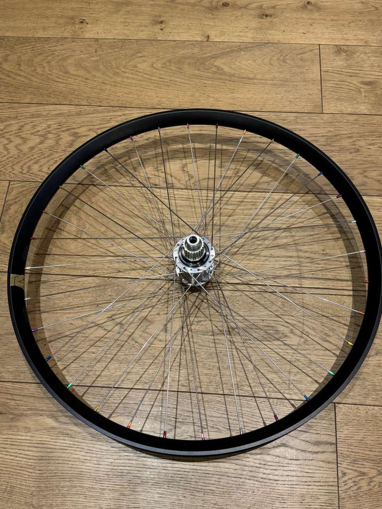

Posts: 677
This thread is just the absolute best of this place. I've had multiple offers to loan me what I've asked for, loads of great advice about what I do and don't need and enough encouragement to feel confident that I can do it. Huge thanks everyone, I really appreciate it and please do keep it coming!
In the right hands, a couple of cable ties and a spoke key will produce a near perfect wheel, whereas you can still build a pile of poo with all the chi-chi kit.
I had planned to tackle it with just the frame and cable ties if that's all I could get hold of but now I'm happy to say that I don't have to.
Ah yes, that's one thing I've already purchased actually although I went for a non-adjustable one from Unior.
Squorx brass nipples are just awesome – I build wheels professionally and I won’t use anything else anymore.
I've heard the same from others but I've gone with regular Sapim alloy nipples purely because I want them in rainbow colours - in fact that was the whole reason I started down this path 😆. I'll let you know when I round them all off so you can say I told you so. There's another thread on this but here they are:

appltn
Ah yes, that’s one thing I’ve already purchased actually although I went for a non-adjustable one from Unior.
Heh, that's the exact cheaper one i mentioned that I couldn't remember the name of 🙂 Thanks!

Posts: 138
appltn - my main reason for only using brass nipples is that I live in a Nordic country where they use road salt in the winter. Riding in salty wet conditions absolutely destroys alloy nipples. I also put some aluminum anti-seize (Park Tool ASC-1) on the spoke threads when assembling, even if the nipples have thread lock already, so they won't seize over time and can be trued later.
I have a couple boxes of coloured alloy nipples that I would like to use one day, but that would have to be a strictly summer wheel build then!

Posts: 4789
Just to really emphasise the vertical true element mentioned about
it is one of the benefits of using the correct length spokes and one of these tools that jump out at the same point:
For std nipples:
cyclus
For end drive like  DT Swiss Squorx
dtswisstorx
have to say using end drive Squorx nipple is a dream, especially with the jump out bit and a electric screwdriver, then bit to full tension with a t handle.
the correct length spokes and the jump outs get you to ballpark so quickly.

I just stuck with the aluminium Squorx nipples that came with the DT Swiss rims. I reckon DT Swiss know what they're about. Well I hope they do because they're on my commuter/everyday bike, so if any are seeing salt, this is the one! Not really been built long enough to comment yet.

I love building wheels. Definitely one of the most rewarding maintenance jobs, and enjoyable to learn.
Regarding DT swiss alloy nipples - I was also skeptical, but they came with some rims I bought so I used them. Been on the singlespeed, used in winter the past couple of years. I just re-dished the front tonight - all moved freely, perfect condition.
I use a DT swiss spoke key (grips on 4 sides and is nice and red and shiny). Definitely dont scrimp on spoke key.

Posts: 66087
Re alu nipples, all too often I've come to fix a wheel and it's gone from a 2 minute job into an absolute bastard because of these, and I've absolutely cursed the idiot that chose alu nipples, and what's worse that idiot was me. Hate them, can't say no to them. "But they save entire grams!" "But they came with the rims and brass ones cost entire pounds!"
rootes1
Yep, when you first see one it looks like it's just a labour saver or corner cut but it's really not, it's a whole better starting point and it makes everything after come easier. Love 'em. I said it earlier but it bears repeating, with the right parts spokes you could genuinely build a usable (probably bad, but usable) wheel using nothing but one of these and literally not adjust it a turn. I mean, equally it might turn out terrible 🙂 I set it too aggressively once and decided just to carry on out of curiosity, and ended up assembling the wheel directly from loose into a part-tensioned, 80% finished wheel in a single pass, you could have ridden on it. For several minutes anyway.
Without one, you spend half of the early stage of the build basically fighting the fact that every spoke started out at a different point, and you've got no datum so it doesn't become obvious how right or wrong it all is, til you've got actual tension in it.

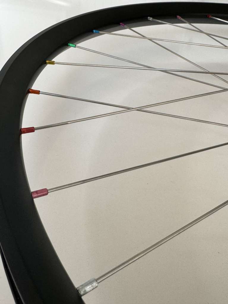

Posts: 12277
...you’ve got no datum...
Right, heres what i do as i don't have a nipple driver. I probably should, but I don't make many wheels. This tip was probably Sheldon Brown's.
Screw the nipples down until there are 2 threads showing. Always worked for me, if you have the correct length spokes it even gets the dish close.
Posted : 20/02/2024 7:08 am
Posts: 3318
Yeah, that's what I do. Works well.

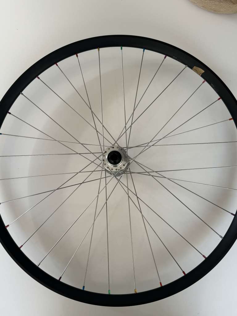

I finished my wheels this evening! It’s extremely satisfying and I’ll definitely be doing it again next time. So nice to know that they’re perfectly true and tensioned and that I did it for myself.
Thanks for all the tips and especially thanks for the loan of the tools @crossed!
Behold
IMG_0679IMG_0678IMG_0676IMG_0675

Posts: 9010
Did you stress them Ali-Clarkson style - laying the wheels on the floor and standing on all the spokes (jigging up and down lightly), then flip them over to stress the other side? Also his method for de-twisting the spokes? Once you've stressed them put them back in the jig for a final true. It's quite fun too. The idea being to stress them before you go out and ride rather than when you do go out and ride.
Posted : 08/03/2024 12:55 am
Posts: 12277
Very nice, and silver spokes too! Definitely better than black, (IMHO)
Posted : 08/03/2024 6:58 am
Posts: 677
Did you stress them Ali-Clarkson style – laying the wheels on the floor and standing on all the spokes (jigging up and down lightly)
Hah, no but I did de-stress following the instructions in Roger Musson - thick gloves and squeeze pairs of parallel spokes all around the wheel after pretty much every addition of tension.
I started off de-twisting with a bit of masking tape on the spoke and watching it move but that was so time consuming that I ended up doing it by feel - hold the spoke between my thumb and forefinger and then notice when it stops moving, then roll back by an equivalent amount. I think it might be a little less precise but saved a lot of time. We'll see how well it worked when I ride them!
Thanks! I think seeing them finished that black spokes would make the colourful nipples stand out more but I quite like that it's slightly more subtle. Plus they're going on a raw stainless frame so they'll match.
Posted : 08/03/2024 10:15 am
