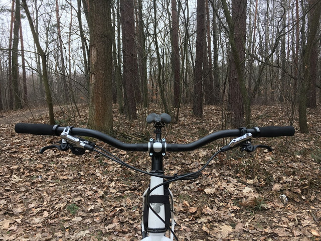

Steel MX bars are heavy as hell, but aluminum ones are under 800g with astonishing 4mm wall thickness 😀 (so forget about your standard barends)
Got one few years back, nice backsweep and 820mm wide, it was also pretty cheap (under 30GBP) and the brand name was Vicma if that will help.
