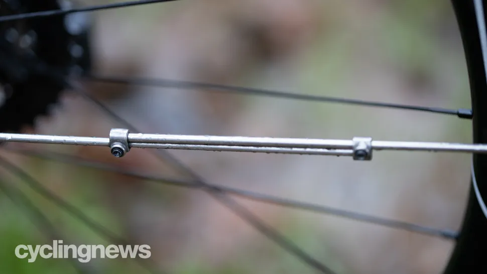

Posts: 46877
Bontrager NCS - mrs_oab has them on and they are wonderful - no cutting of stays, easily adjustable stays and more rigid than our previous SKS ones.
https://www.cyclingnews.com/reviews/bontrager-ncs-alloy-mudguard-set-review/

Invest in a Dremel and one of those hardware store sets of different sized stainless steel nuts, washers and nyloc nuts 😂
Otherwise PDW are my go-to every time, quieter and sturdier than thermoplastic, and none of the pokey-outey ends on the stays as the stay ends telescope into the sections which bolt on to the stays. Edit: similar to those Bontragers above.

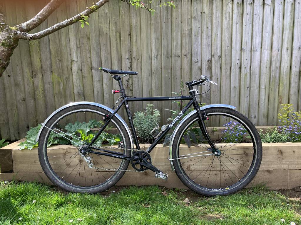

Posts: 808
Velo-Orange in your preferred finish, colour, and width for me.
Can be a pain up front to fit, but after that they are as close as I’ve ever got to fit-and-forget in terms of mudguards. They don’t rattle, are really strong, great coverage, and easily withstand a few scrapes and scratches along the way.
