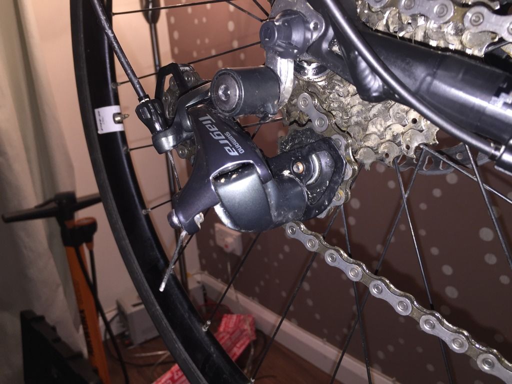

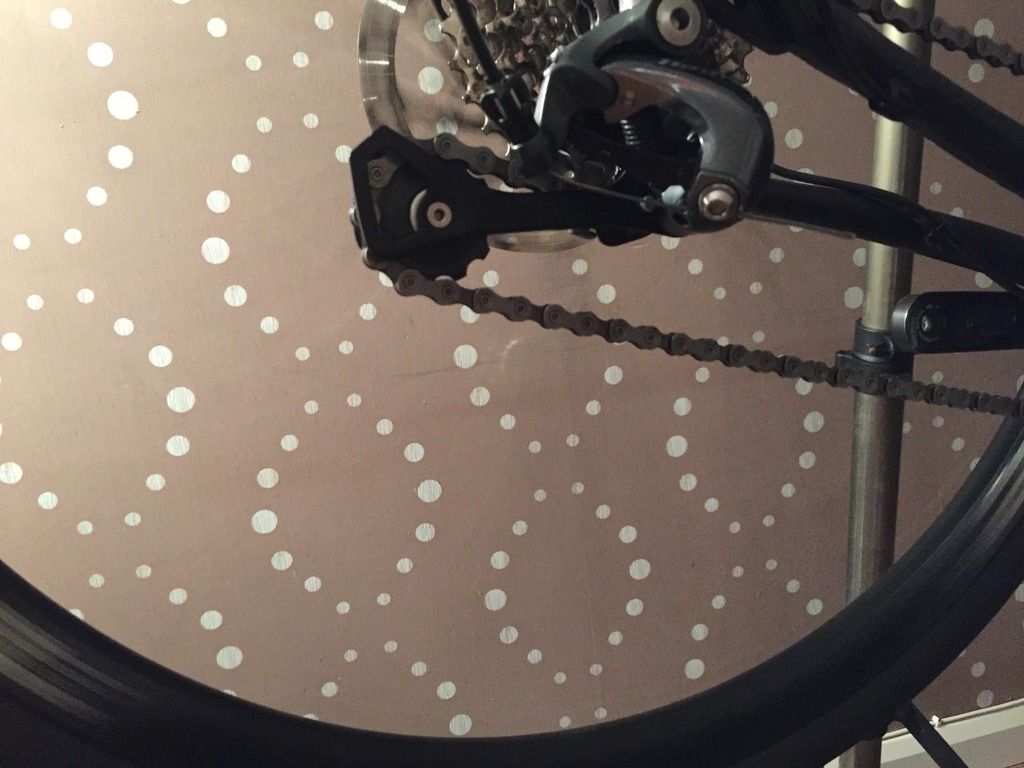

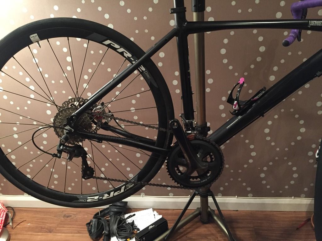

It rides ok...it shifts just fine.....just doesn't [i]look[/i] right to me, somehow?
PX London Road, 50/34 chainset, 11/32 10-speed cassette.
I dunno any more. What think you? Here's a big-big, small-small, and zoomed in small-small shot.

Here's another form below the mech in small-small:

Posts: 2082
You could loose another two links out of that.

Just take one out to start with.

Posts: 1369
Yeah, will do- ta

It's definitely a bit too long - I'd start by taking one link out and seeing how it looks then.

Posts: 6985
two, minimum
i like a tight mech
Posted : 21/12/2016 10:53 pm
If the mech cage is horizontal or past that when in small/small then due to the angles involved it will have difficulty controlling the chain tension effectively and is also very close to its end stop.
In fact yours is on its end stop.

Posts: 1369
Looks better- thanks.
