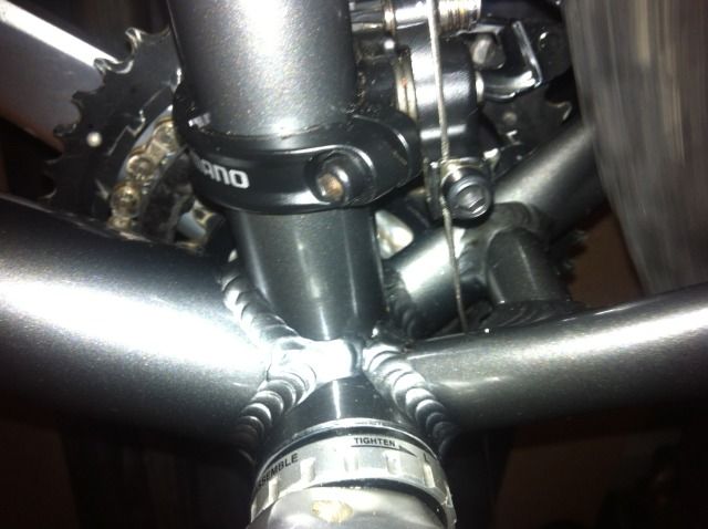

So I'm setting up a bike for my sister, XT front mech, deore 3 speed shifters. I set it up just as normal but them I go for the big ring and it's like i'm hitting some resistance, pulling the cable makes no difference.
I checked to see if the mech is catching on the ring but its clear and i've turned the H limit screw and that makes no difference.
What am I missing?

Fixed it. 😳
When fitting the cable it has a slot to the left of the screw. It's a pretty fine channel so it looks like it'll fall out. So with the bolt there's a shaped washer the folds round to the back offset to the slot.
I figured this piece was to pinch the cable and make sure it stayed in the groove but it's not. The way I had it fitted means that it interferes with the clamp as it goes for the top ring.
Washer moved, full range, works perfectly!
