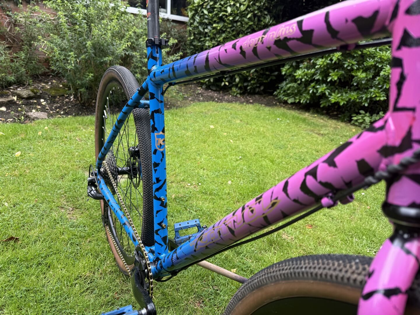

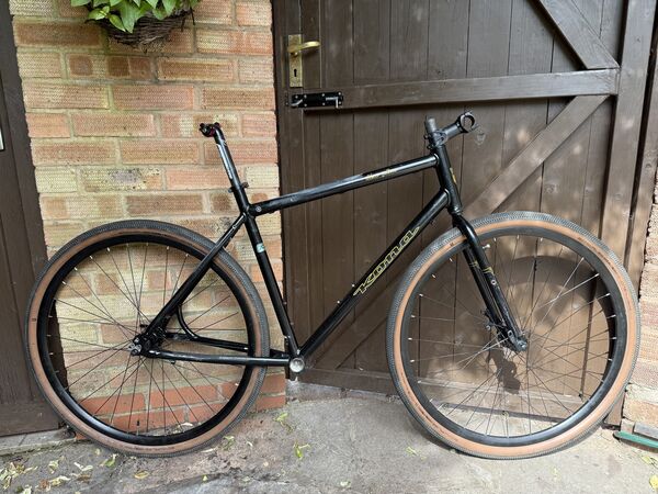

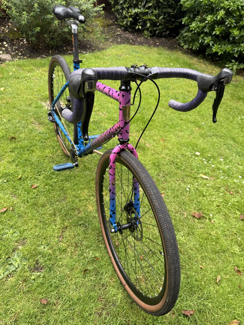

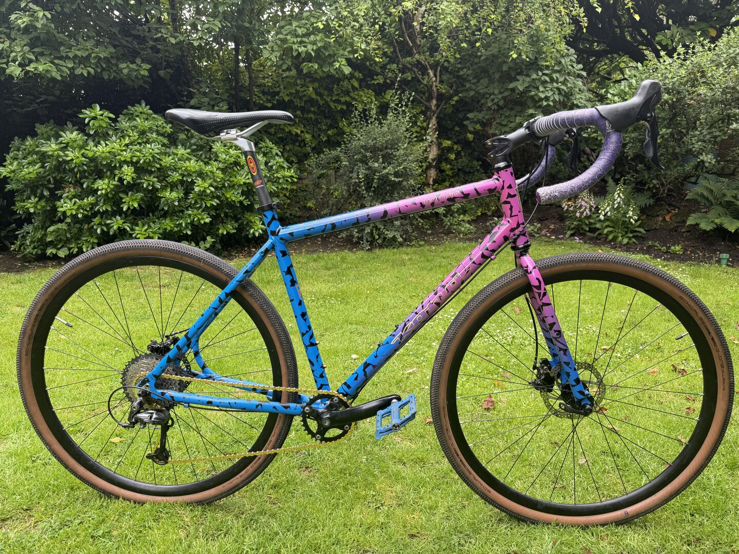

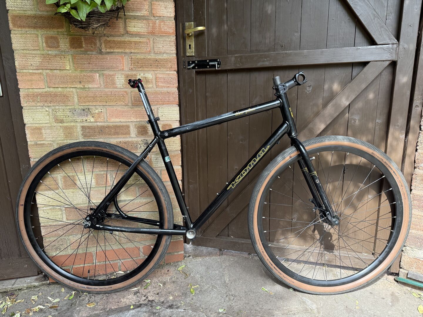

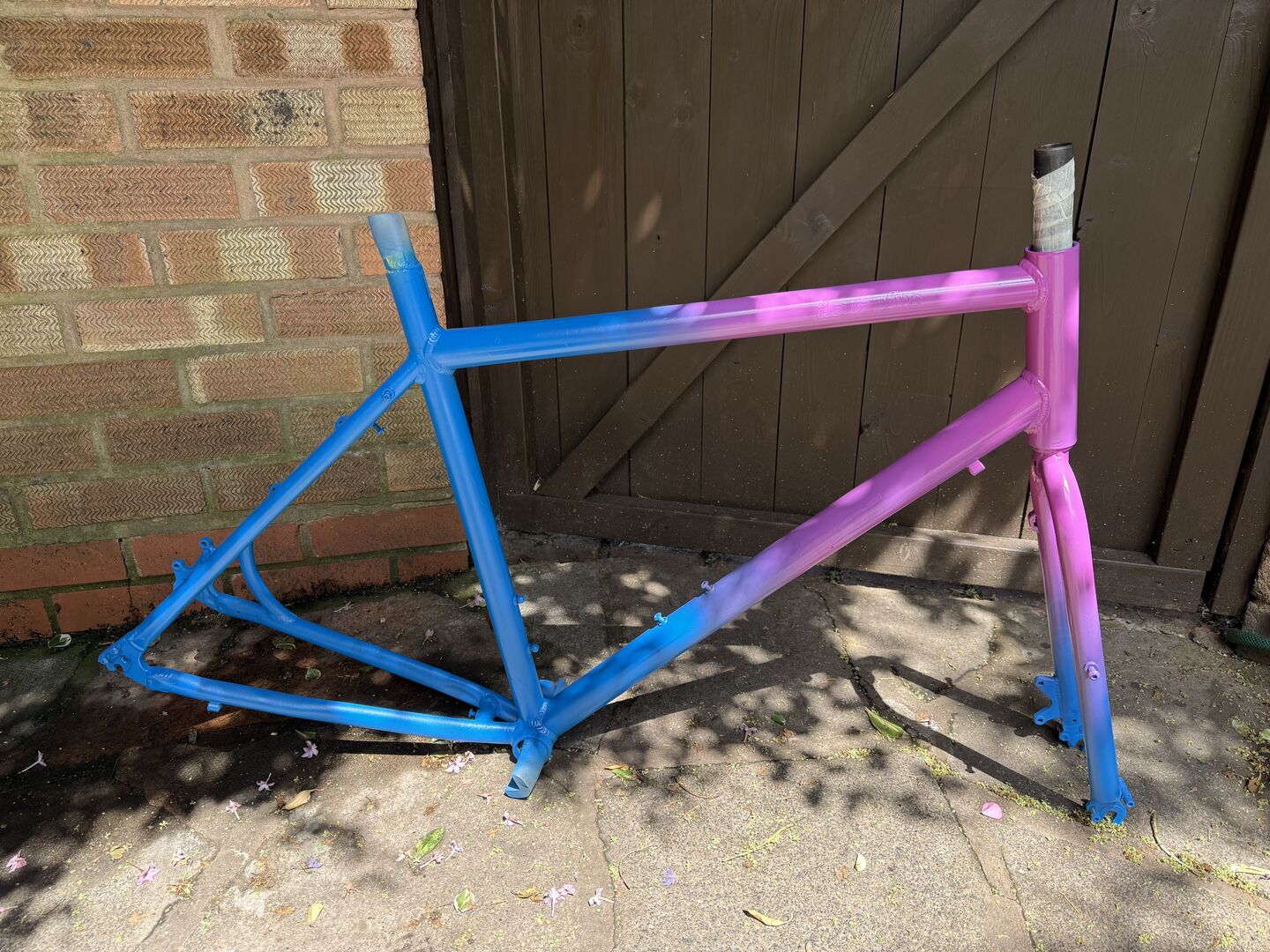

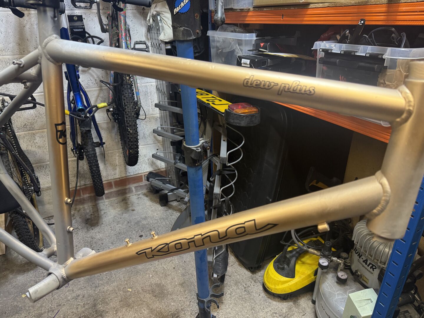

Picked up a battered Kona Dew plus frame as I fancied a little gravel style project.
I think it turned out pretty well. Went for the 90's fade with extra whammy.
The lawn is even recently mown too.

That’s a lovely paint scheme

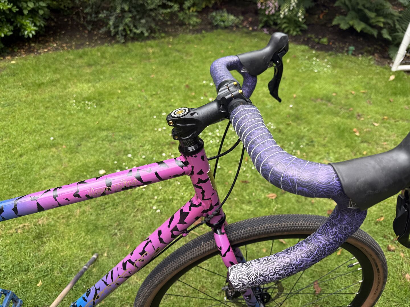

Posts: 3731
Very nice!
Are you tempted to paint the stem, bars and chainset?
Posted : 17/06/2026 4:20 pm
Posts: 1735
Thanks all, needs a different seat post I think.
Gate has been the bane of my life....i'm just grateful it closes!
Was tempted to paint the stem and chainset but think that may be OTT

More details on how please.
That's great fun.

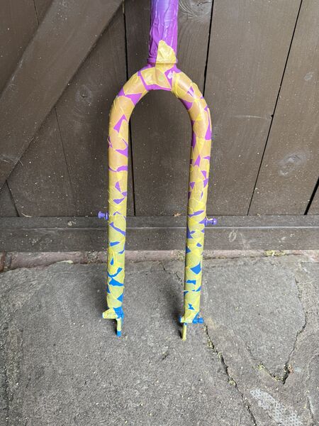

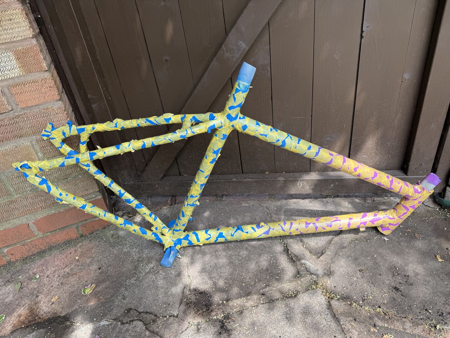

Posts: 1735
It was a slow burn but good fun.
  • Key the original black paint
  • Grey primer
  • Gold spray in the areas for logos
  • Vinyl decals over the gold - fork logos were too small so didn’t come away cleanly
  • Fade the whole thing
  • Get 7 year old child to help apply tons of masking tape pieces.
  • Black spray the whole thing
  • Peel off tape and vinyl
  • Clear coat
I used cheap spray paint from Amazon and a cheap (non-2K) clear coat rattle can.
I started to use spray.bike but always leaves a rough finish.
Wet and dry in between coats when I could be bothered.
