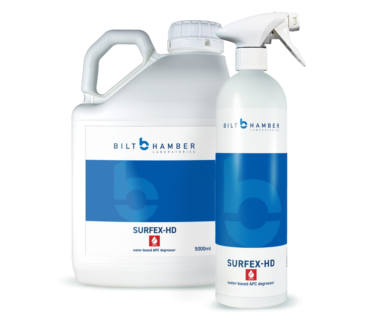

Posts: 5683
Bilt Hamber Surfex HD. Water based pH neutral degreaser.
It needs diluting, 1 part Surfex HD to 5 parts water for extreme degreasing. I use it at 1:10 for car alloy wheels, no need for dedicated acid wheel cleaners, all the way down to 1:100 for car interiors.
I’ve used Surfex HD on gold chains at 1:10 and it works perfectly. On non coated components I follow it up with Bilt Hamber Atom Mac. A very strong rust inhibitor.
Posted : 11/12/2021 8:00 pm

Love my bilt hamber surfex HD use it everywhere, car interior, bathroom, carpets windows and more and costs pennies.

Posts: 4338
Website says its alkaline pH 14?
https://www.polishedbliss.co.uk/products/bilt-hamber-surfex-hd#product.keyfeatures
Posted : 12/12/2021 12:31 pm

Posts: 5683
Oops. My mistake. Thinking of one of their other products.
I’ve used it without issue.
