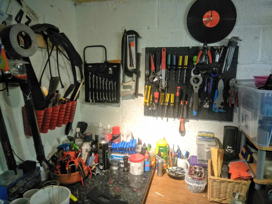

Posts: 6410
Get yourself a tool board, makes life a lot easier compared to scrabbling through a toolbox.
This is just a cheapy Lidl one, I keep meaning to make a better/bigger one.
