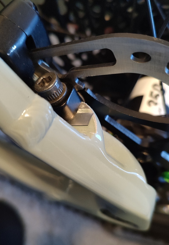

I did a frame swap. New frame is 2025 Orbea Laufey.
Rear rotor is not parallel to caliper seen from above: the top of the rotor is touching the lh pad and the bottom of the rotor is touching the rh pad.
I can't get rid of rub obviously as I run a tight clearance and no dead travel.
Those brakes were fine on the old frame so the culprit seems to be poor brake bosses alignment on the frame.
Solution?
Do they do a "wedged shim" that I could put between frame and caliper?

If not, what kind of brake mounts does it have? Post Mount or flat mount sometimes need to be faced. A good bike shop can do it or careful use of a file can sort a steel or aluminium frame. Carbon probably needs a shop for the fancy Park Tool tool.

Are they new pads? Yes, the new frame may need fettling, but the old one may have too. Limit of tolerance on the old one and worn pads could equal limit of tolerance the other way on new one.
It's not super likely, but it's cheap - try new pads.

Maybe try thin washers to adjust alignment. That'll be the cheapest thing to try initially. You could then file/linish a shim depending on your access to tools etc

Not using adapters btw, it's a 180mm rotor on a frame natively designed for that size. The rotor is almost perfectly straight btw. I tried another new rotor and that didn't help.

Also, try conical washers on top of the calipers, it can sometimes give just enough adjustment if the two mounts aren't parallel.

Post or IS tabs can be faced with a special tool, very accurately. At times it wasn’t uncommon for new bikes to require this, find a mechanic with the correct tool.
A cheaper and less accurate option is to use a file and do it by hand or use some special washers, I think Hope did then, like a “C” shape. If I go down to the workshop later I’ll post a picture up.

Have the mounts faced. Ditch the conical washers if you have them, replace with flat washers. New pads.

Thanks. Spoke to the LBS and they don't have the right tool, apparently it's quite expensive. I am quite relieved in a way as they are shit anyway. I have tried to file myself but that's tricky as I don't want to file too much or the wrong way., which I am very confident I will do. Either way it didn't do anything.
I just want some washers that can offset the issue but I don't think they exist, way too small a market. Can I just bodge it with small strip off aluminium from a drinks can?
I tried to swap the pads to no avail.
Running out of ideas as I'd rather not ride it than having constant rubbing. I have another bike.

Freeborn would have a brake mount facing tool I’d have thought? They close by?

Done!
Had to sacrifice my last can of cider but just a bit of it on one side of the bolt made enough difference.
Thanks all. Will have it done properly if I keep the frame long enough.
