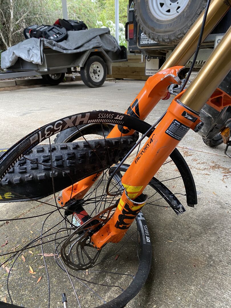

… like not drive into things with your bike on the car?
Tell me they didn’t happen riding!
Posted : 27/04/2026 12:34 am
Posts: 124
Alas it did happen riding, got cleaned up by a 4wd and dragged down the road. I didn’t do much better than the bike. 😳
