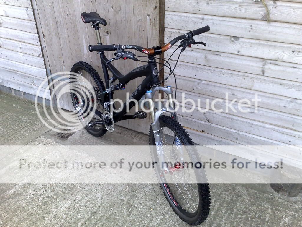

One good thing about all the snow, been meaning to take pics of my build for ages 😀

Odd way to run your shifters/brakes, but otherwise, rather nice!

I don't get it?
It looks like an XC frame but with an E-13 and XTR cranks?
What's it for?
XH?
DR?
FC?

Lots do it (me included) helps with 1 finger braking

I don't get it, whats odd about the shifter set up??
Brakes set up for 1, maybe 2 finger braking, and shifters closer to the grips?
Whats wrong with that? ❓

Nice bike. What's the matter with the brake/shifter set up? That's the way I run mine, although maybe not as far inboard.

Why? brake lever in board for 1 finger braking, my intense is almost the same.
They are VERY in board though..... I still don't get it - what's it for?

Maybe it's because I have mine on Matchmakers, and still have a perfect one finger braking and easy shift set up (Avids and Sram). Maybe it just looks funny to me.

Are they tallas forks because otherwise you have ruined the 575's climbing capabilities with a 160 fork and all those spacers under your stem.

The shifter set up is perfect for my big hands, and one finger braking.
Admittedly they are a little far apart but when bombing down some singletrack, its probably the last thing i am thinking about.
Its comfortable

Got my glasses on now and can see they are tallas. Would still drop some spacers though.
Do you have extra fingers? The tip of the lever looks in board from the inner edge of the grip!

It looks like an XL bike so he probably has large hands and needs to run the brakes further in on the bar. I know some kids who still like to brake with all their fingers but I thought most seasoned bikers like to brake with 1 or 2 fingers to keep better control of the bike. Maybe apart from the light weight cranks I don't see anything wrong with the build! Looks like a great bike to me. Maybe a few green eyed monsters out there?

I do have very big hands, i am a big guy ! 😉
As for the champagne truffle, etc etc. The point about a self build is that you can spec what you want. I happened to want an e 13 with XTR spec.
I know that the whole point of forums is for people to voice there opinions, so hey, if you dont like it, no biggie. Its your opinion.
I happen to LOVE IT, dream build and all that.
To the peeps that said they like it. - Thanks !
To be honest i havent even ridden it properly yet, die to the snow, so may drop the spacers yet.
See you all on the trail 😀

Which is cool. That's why I'd ask the question. If you want an XC bike with an E-13 then it's fine - I just like to know you've thought about it rather then just bolt the blingest bits you can onto a frame.

One of the reasons i wanted an e-13 was because my last outer ring, took a huge slice out of my calf 😳

As i said, it was [b]one[/b] of the reasons i got an e-13, the other is that at 220lbs i have a very low bottom bracket, even with 260 lbs of pressure in my shock.

OP's lever placement is how it should be for one finger braking, I'd argue that the levers are pointing down too much though 😉 Should be inline with your arms (or thereabouts) but of course, if its what you find comfortable....

i reckon as you are a reasonably big fella you ought to consider ditching some stem spacers and running a wider bar; it would balance your position on the bike better, letting you put some weight on the front wheel when you need to. slack angled, long forked, high handlebar-ed bikes are all well and good down fast, straight stuff but try carving a turn over loose or bumpy ground and you will will see why Dhers try and get the front end as low as they can (within reason).
nice bike, i run my brakes like yours too. those e13's are twice the weight of most other bash rings though. flatboys are brillant pedals but you can get some almost as good at half the weight. you could save a pound just changing those two parts! its your build though...

It's not the looks I have an issue with - it's the bits - which has been (sort of) explained (as in it has DH parts to save personal injury when riding!?!?!?!)
I've gouged the back of my leg with chainrings before - it was one reason I got a bash. What's your problem with that exactly?

Fantastic looking bike with a great spec, enjoy with passion !
Posted : 11/01/2010 12:39 am
I think it looks awesome, and I totally know where you're coming from with the bash guard, same reason I fitted mine to my Trance X.

Liking the shallow depth of field in the photos - good bokeh!
(The bike looks rather nice too!)

Very nice looking bike. Very nice photos as well.
And at the risk of sounding stupid, (I've always wondered this) how do you make the bike stand up unsupported in that first picture?
Posted : 11/01/2010 1:22 pm
[i]how do you make the bike stand up unsupported in that first picture? [/i]
Small stick and photoshop 🙂
Posted : 11/01/2010 1:33 pm

Looks mighty fine to me
Posted : 11/01/2010 1:41 pm
Posts: 5941
Floats my boat. Cracking looking bike.
Posted : 11/01/2010 1:46 pm
Posts: 17828
I reckon if you post pics on a forum, then you have to take the -ve as well as the +ve. Which the OP seems to be doing.
Bike looks OK to me, but the frame looks a little disjointed where that straight member comes across the frame near the lowest point of the swoopy top tube. Just my opinion of course.
Does it matter where the brakes sit on the bars, so long as they are comfortable for the rider?
I've clattered my outer chainring plenty of times mainly due to a lack of skill, but also due to a low BB. I'd quite happily fit a bashring to my crankset (or even a doube & bash if I was taking it to Spain) but would probably go for one of the lightweight RaceFace jobbies.
Enjoy it.
