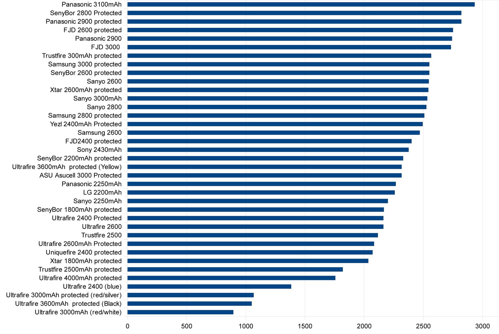

Somewhere between 1:00 and 1:20 the light falls to an unusable level on one fully charged 2400 mAh ultrafire. At 1hr in, it was quite warm, but then hadnt been moving.

http://www.torchythebatteryboy.com/p/batteries_21.html
they are two thirds the way down this graph
Posted : 10/10/2011 4:30 pm
Thats a handy graph stoner. Who produced it and how?

look at the torchy link, rich
