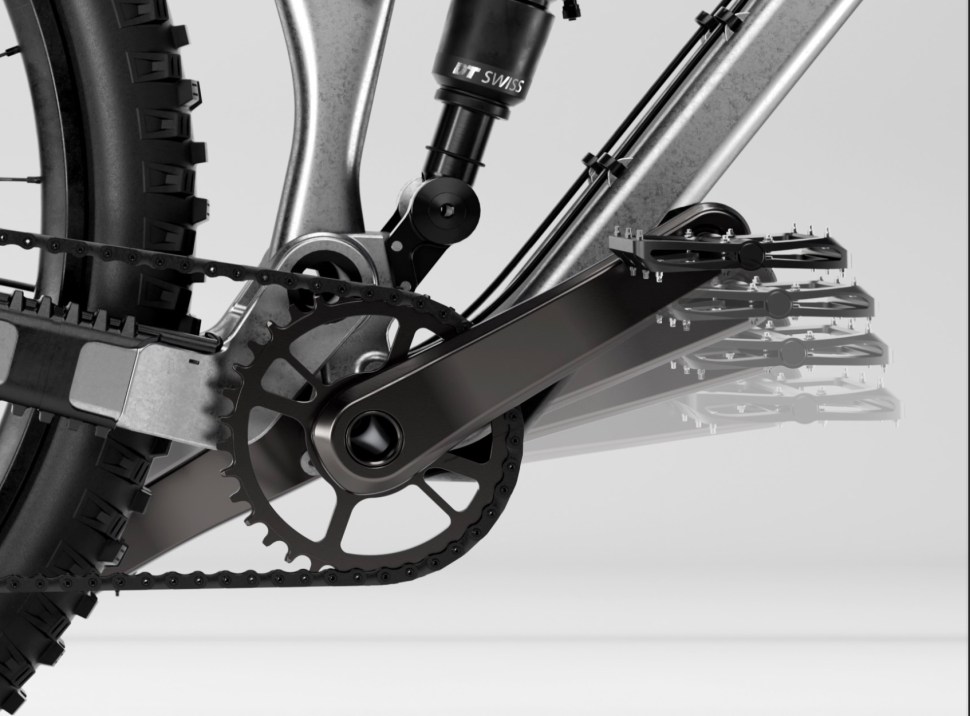

DT Swiss' new anti-pedal kickback 'DF' ratchet system
Posts: 1753
wpf-cross-image
Choose your float: 0°, 10° or 20°. Retrofittable to all DT Ratchet DEG rear hubs too.
Posted : 18/09/2025 2:00 pm

I’m inclined to agree with chakaping and this DT Swiss hub seems like a very simple solution.
A friend of mine recently got. Tairin silent hub, then promptly broke his collarbone. He probably won’t get much time on it to give an opinion before winter.
Tairin are a small Canadian company who, as far as I can tell, were the first to bring this kind of hub to market.
one thing that would concern me about these kind of hubs is how many degrees you’d need to turn the crank to reengage the freehub.
Posted : 18/09/2025 3:34 pm

A question I have is what setting changes you’d need to make to the shock to cater for the unencumbered movement? Presumably you’d need to increase the compression damping
Another question is how these changes would impact the performance of the suspension while climbing?
perhaps we’ll see shocks with “descend” switches rather than “climb” switches so that you can firm thing up for when the drivetrain is disengaged!
Posted : 18/09/2025 3:51 pm

Good points, though I don’t know if a free coaster hub is simpler than this DT Swiss solution. The float in these systems is constant, unlike degrees between engagement in a low engagement hub.
personally, I would like to try one. If they made my feet less achy at the end of a fast and chunky descent I’d consider it more fun and I think it’s fun when my bike feels like it’s working well.
Jeff Kendal Weed isn’t convinced by these products, and he’s far from an average rider
And Joe Starling isn’t convinced kick back is a problem anyway
if I had the compatible hubs, I’d probably give this a go, but I need new tyres and they’re expensive enough.
Posted : 18/09/2025 5:23 pm

I can't be bothered to type all my thoughts on pedal kickback again. Basically, it may or may not be a thing and it definitely affects some bikes more than others. If you're not bothered by it, don't worry about it.
'Chain-flail' though, or whatever you want to call it, is definitely a thing. It's why old bikes had DCD's and Bullet Bros. tensioners. It's why modern bikes have clutch derailleurs and moulded plastic frame protection.
Chains are heavy, noisy and they whip up and down all over the place when you're riding off road. That whipping tugs on the chainring and therefore your feet.
That's why I fitted a Rimpact Chain Damper to my Airdrop Edit MX. They were more honest about aiming to mitigate chain-flappyness than trying to make unprovable claims about pedal kick-back.
My honest review is that it works exactly as advertised. Effects will vary from bike to bike but it's eliminated chain noise for me and removed a load of vibration and feedback from my pedals which I didn't even realise was there. For the steep, chunky trails I like to ride it's perfect.
As luck would have it, my other bike has DT Swiss hubs compatible with this new gadget so I might be able to test both side by side.

One thing I did note, all of the videos illustrating it have static bikes, chain on the 52T sprocket, being heaved up and down on by someone, essentially exaggerating the "kickback" effect, is that a realistic representation of most people's riding? surely the effect is substantially reduced in smaller sprockets? Are people going deep into the travel in bottom gear very often? If so, That's some Gnarly climbing.
Posted : 19/09/2025 12:35 pm
Posts: 8834
Posted by: cookeaa
No, it illustrates what kickback is but has nothing to do with actual riding.  I’m pinning my hopes on Rimpact guy being correct about chain flail being what I actually feel.  Two things I am fascinated by in huck to flat videos, how much forks flex and how much a chain flaps around and even slaps the ground.  Actually make that three things because I sort of like it when something breaks too 😀
Posted : 19/09/2025 12:47 pm

Maybe not, the DT system seems to be like the internals of an impact driver, the internal ratchet just floats back 0/10/20deg then needs to be pulled forward to engage.
Whereas free coasters rely on a helical driver pulling the 'clutch' together.  The advantage of that design is it disengages completely the other way. There would be zero pedal kickback because without a ratchet you can spin the wheel backwards indefinitely without the pedals moving, it needs pedaling chain tension to engage it.
Actually, wouldn't Shimano's Sylence hub design achieve the same thing as the DT?  The idea was that you had to pedal forward a fixed amount to bring the ratchets together?
Posted : 19/09/2025 2:23 pm
