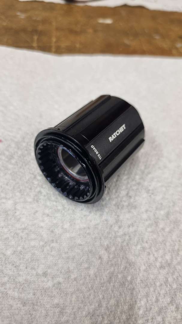

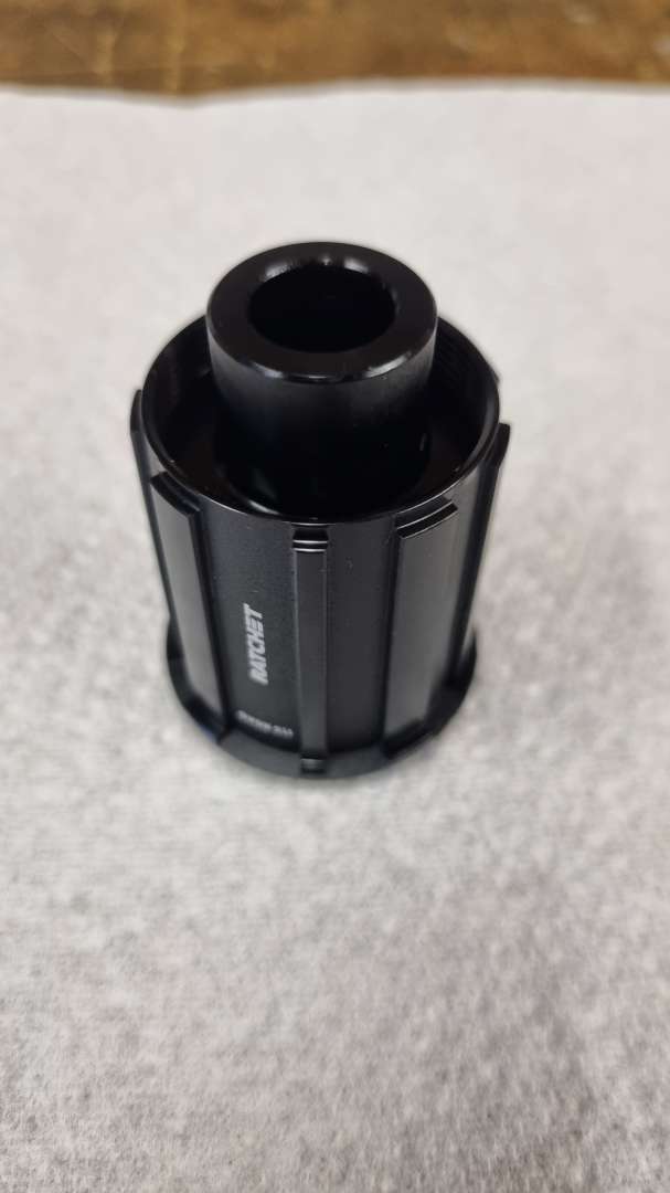

Posts: 1468
I'm really sorry, but I think I've misremembered the free hub that I had... Just checked and it's off a 350 hub, but it's 11 speed and not MS as I recalled

Posts: 6841
Posted by: stanley
I'll buy this or swap for a SRAM fit XD (new and unused), assuming it'll work for MTB as it has Road written on it. PM'd you.
