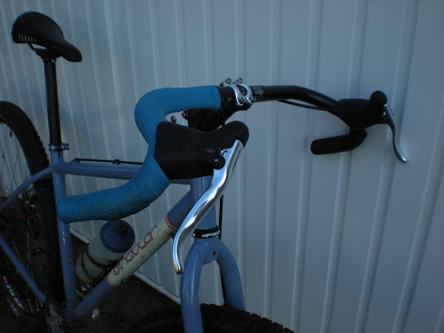

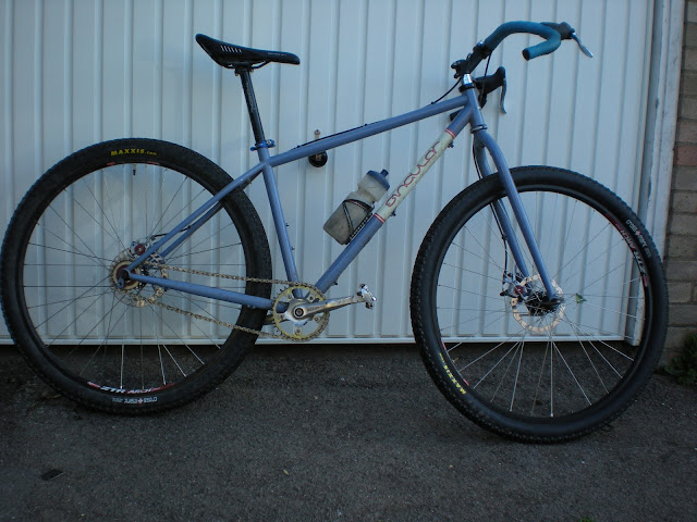

Inspired by threads here and elsewhere about drop bars off-road, I've fitted them to my bike (rigid single-speed, 29").
All is not well though.
I've got Midge bars, a hi-rise stem and Avid BB7s from the classifieds.
They're fine most of the time.... but going down a couple of reasonably bumpy descents I found that my hands started slipping backwards down the bars and away from the brake levers.
Is this normal? Do I just need better bar tape? Or should I just get some proper wide risers?

Only one side has bar tape on at the moment, but it was the side with the bar tape where I was slipping towards oblivion!
Maybe I'm just inept....

it's quite shiney bar tape - try something a little more 'suede'

skateboard grip tape? do you get a nosebleed holding the bars in that stem?

Have you sorted out the saddle angle?
Your bars might be a little high. I have the top of the bars a little lower than my saddle, I think. It also takes a while to get the angle of the bars right so you might need to experiment with that.
The drops on mine point much further down than yours, and my brake levers are further round the bar.

[i]brake levers are further round the bar[/i]
I thought this when I saw the picture, and then I scrolled down and someone who knew what they were talking about thought the same. 🙂
I've now got some cork/gel tape on order from CRC. That might help. Not noticed the nose bleeds.
@miketually - the saddle angle feels fine; I think my photo has a somewhat skewed perspective on it. The tips of the drops are about an inch below the saddle.
When you say further round- do you mean towards or away from the tips?
That sounds far too high to me; the [i]top[/i] of my bars are about level with the saddle.
Further from the stem.

Those bars above..how on earth do you ride on the hoods? And is there any real point in having any kind of drop bar if they are going to be higher than the saddle?
Edit; If youre using those bars then I'm not surprised youre slipping as the ends pont downward. Off road you want your hands to fall into the bars.
Imagine hanging from a vertical bar and how hard that would be compared to a horizontal bar.

The bars aren't as high as they look in this shot,
Eh? It's leant against a wall so you can see the height of the bars and saddle relative to the pointing!
What olgit said - they're just like Marys etc with more sweep.

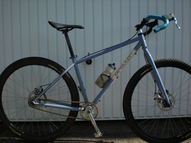

Another picture, slightly better angle.
Thanks for the suggestions. I'll try pointing the tips up a bit more, and some grippier padding.

Just spend a bit of time experimenting with the height and angle of the drops and brake levers. The centre of the stem clamp on my midged Inbred is about an inch above the top of the saddle and the drops point to somewhere above the rear wheel. No problem with slipping off the hooks yet.
[url= http://farm5.static.flickr.com/4019/4531178422_442e6029b1.jp g" target="_blank">http://farm5.static.flickr.com/4019/4531178422_442e6029b1.jp g"/> [/img][/url]

Turn the bars in the stem (rotate clockwise when looking at the bike from the driveside), try better bar tape. I'm not sure I see the point of those bars though - maes bars have enough "hook" on the bottom that there's no way your hands are going to slide round.

luked2 - you're wrapping your bar tape the wrong way I think. You should wrap from the bottom of the bar towards the centre - that way your weight on the bar has a tendency to flatten the tape rather than rolling it off.
