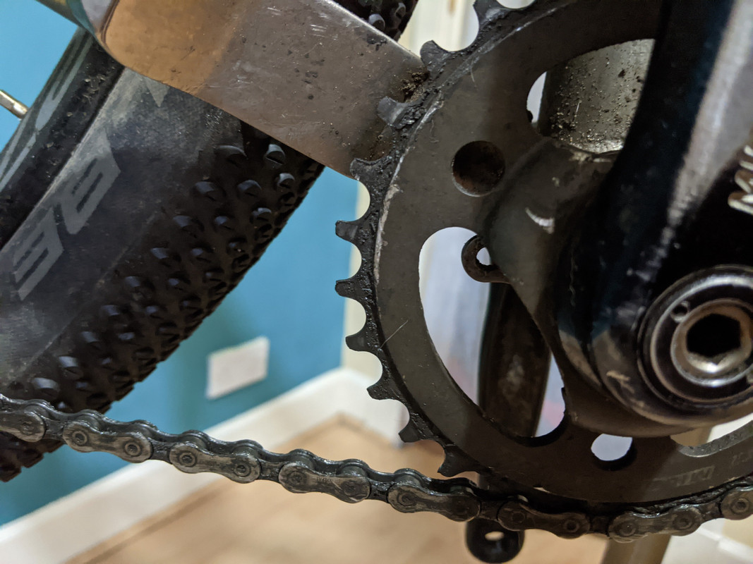

Bit of a thread revival. Just revisiting as the bike had been stolen but I have it back now.
@Hadge - I *think* you PM'd me to ask for a pic of the teeth on mine? I don't have any of my old PMs from then, but here is a pic:
I've found that having a clutch mech on/off doesn't make a difference, but am using a Superstar top chain guide thing someone gave me which is working pretty well at keeping the chain on.

Have you got a chain measurer? Because at first glance, that ring looks pretty worn.
Posted : 02/09/2020 9:06 am
Posts: 5296
It could be! I got the ring with the cranks when I bought them, but have no idea what they are meant to look like so not sure if it is worn. The chain and cassette were new, and chain thingy says the chain is currently at 0.75

Posts: 394
Blimey, that chainring is utterly shagged.
