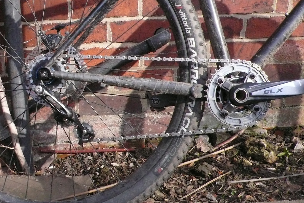

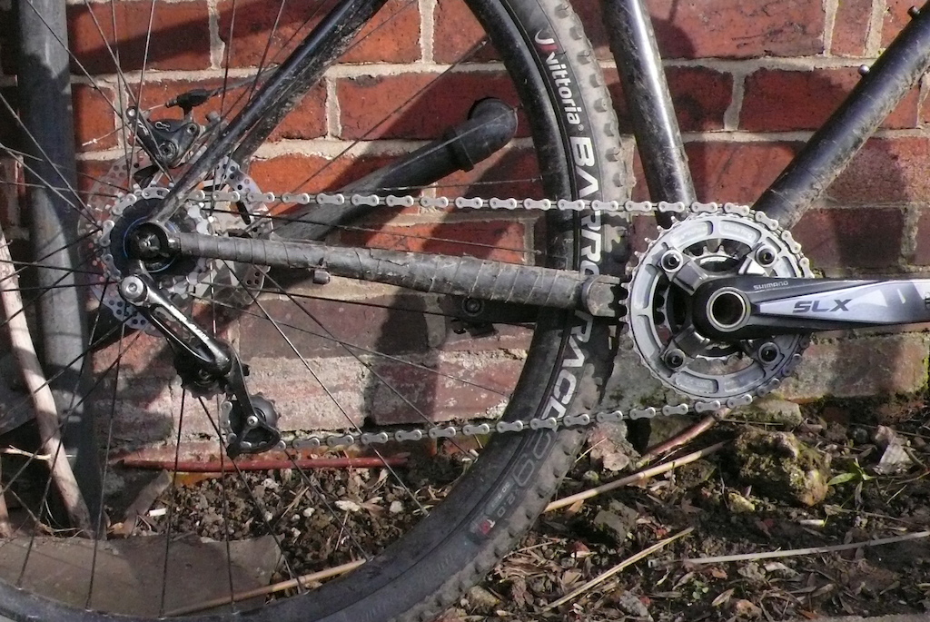

Well it turns out I had to leave work yesterday as a migraine meant I couldn't look at a computer screen, but playing with tools in the garden helped 🙂
Also turns out I had enough stuff to try something out. I put an alfine tensioner on with 18t and 21t sprockets at the back, matched with the 37t chainring that was already on there. The sprockets are so close together that it works with the Alfine set up halfway in between. There's a little noise but nothing intrusive, and there certainly isn't anything rubbing. Takes only a couple of seconds to change gear.
I’d probably be inclined to see if I could bodge a Singleator style device to have more float on the jockey wheel
I can't think how to do this, but what I will do if put a worn jockey wheel on the top so the chain has a bit more lateral movement. Given it already works now I reckon this'll do it.
The two jockey wheels idea is a good one, if I ended up adding another chainring to the front I may try that. Or the rear mech with a short length of cable idea, that's a nice fix. That would be good as I'd technically then have a fingle speed, if all four combinations of cogs were different. Although that's beginning to defeat the object of not having gears 🙂

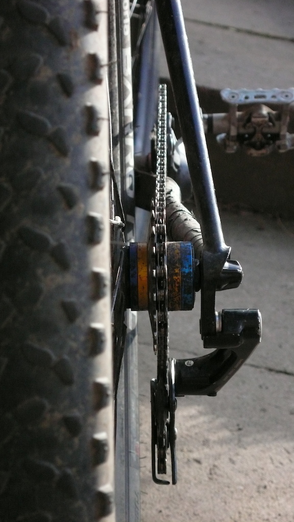

Now I see I need to sort the chainline... Hard to get that Alfine any further out, so going to have to shift the chainring inwards
...and...
Looking at those pics again, there's really not much slack in the system when moving from the big to small sprocket. Reckon I could get away with a standard single-jockey-wheel tensioner?

Ooh, those sprockets are *close*.
I'd at least try a single-arm tensioner. The current configuration's at the point where you might as well just add a shifter and a cable 😉

Posts: 1679
Ya, I was surprised I could get them that close with no rub, but then I measured it up next to a 10sp cassette and it's basically the same (that is, if sliding two butter knives into each gap counts as taking a measurement...)
I’d at least try a single-arm tensioner. The current configuration’s at the point where you might as well just add a shifter and a cable 😉
I've wondered that tbh... However, it seems I've had that Alfine for at least 7 years and it works like new despite me not doing anything to it and having ridden it pretty roughly 🙂 So still a lot simpler than a gearer set up
