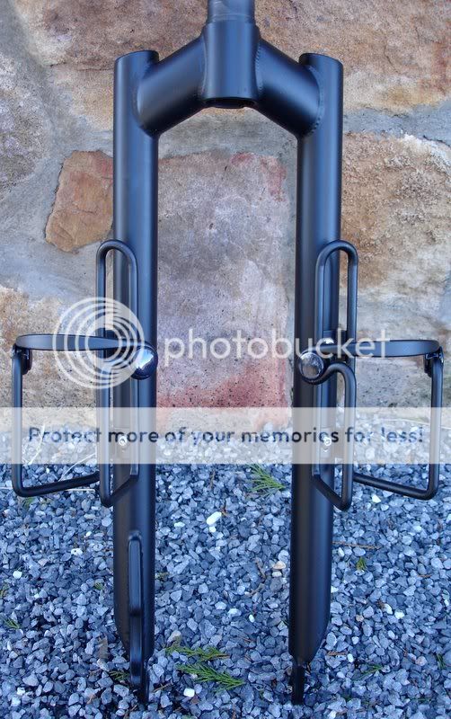

we are doing a little cycle tour in 2 weeks, my first. Scary stuff!
ive got a sexy rear pannier rack, and pannier bags sorted, but i hear for road touring having all your load over the back end isnt sensible (and Euro style is to have up to 70% weight over the front)
is there any known way of putting kit onto a standard On One steel fork?
i dont think it has any rack mounts, the only bolt holes available are the four for the canti bosses.
Im thinking of bolting some modified bottle cages onto the canti boss bolt holes and storing the heaviest stuff in them, they are for holding on brakes so should be sturdy enough!
its that, or jubilee clips i figure!
any other suggestions?
any crafty bodges out there?

ding dong. that would work.

I had mine modified with extra bottle bosses (salsa fargo style) since there is only 1 set on the frame, to carry more water and put a little weight up front

similar to that restless native, ive just had a root around in my spare box, and found some cheap bottle racks, where by the bolt mounts are plastic, cast onto the alloy frame.
this means that 5 mm bolts could be "persuaded" through the 4mm holes, and the lower bolt hole slides up and down.
ladies and gentlemen, i give you my bodge of the day
maybe a lick of paint is required, as they came off my first MTB back in the early 90s, but they work ๐Ÿ™‚

No clearance for fat tyres, but for off road will use a sussp fork.
