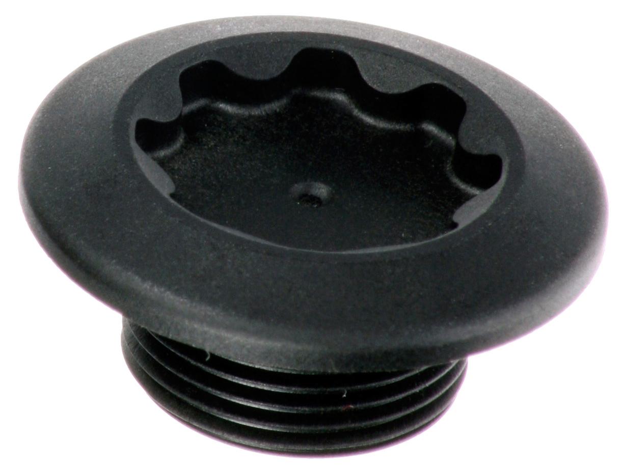

Posts: 28592
Check the crank that fell off. If it's a Shimano BB Ideally there would be one of these screwed into it to pre-tension the BB.
[img] http://i1.adis.ws/i/washford/351764?$pd_merchzone$ [/img]
If the crank fell off I'd expect that to be missing too or still in the hole in the crank because it hasn't been properly attached.

Posts: 102
I've always removed that plastic pre-tension thingy once I've done up the two bolts on the crank. Are you supposed to leave it in? 😕
Posted : 01/04/2015 5:22 pm
Posts: 28592
Now there's a question. It would be crushing to find out it wasn't necessary after all. I've always wondered why they made the thing out of cheese. 🙂
Posted : 01/04/2015 5:25 pm

Posts: 4747
Martinhutch- mine lives in the toolbox after its done its job.

Posts: 58
It's supposed to stay in place or the threads fill up with dirt. Same principal as dust caps on square taper cranks.

Posts: 4747
My apologies, I didn't look at the pic and was thinking of the plastic bit that goes into that.
and in case that sounds smartarse ive made dumber mistakes (much)
See 🙂
Posted : 01/04/2015 9:36 pm
More pish! Not used dust caps on my cranks (or valves) for decades. No issues.
Posted : 02/04/2015 8:21 am
Posts: 28592
More accurately, this is the picture I should have used.
Not much dust-protection qualities there. I don't know if it actually plays any role once it's been tensioned up correctly and the crank arm bolts tightened.
Posted : 02/04/2015 8:27 am

@ martinhutch AFAIK - no it doesn't hold anything when the bolts are tight. But it does keep the smegs out of the threads for next time.
My XTR c.set came with an ally one, so I figure it's for keeping/using or Shimano wouldn't bother.
In an emergency [lose pinchbolts] it might help keep the thing together and prevent spline damage 'till you get to a Hexkey.

you can buy the shimano preload bolt in cnc;d alu, in a choice of colours with a much more agreeable 10mm allen key hole. Looky [url= http://www.ebay.co.uk/itm/351256072138?_trksid=p2057872.m2749.l2649&var=620420697024&ssPageName=STRK%3AMEBIDX%3AIT ]click[/url]
