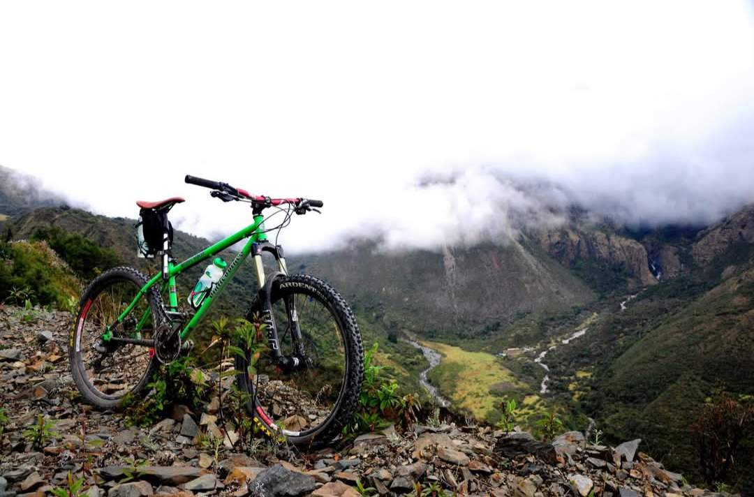

Well, if we're doing Dialled Bikes, and I think we are, here's my Prince Albert when I took it on holiday to Peru.
