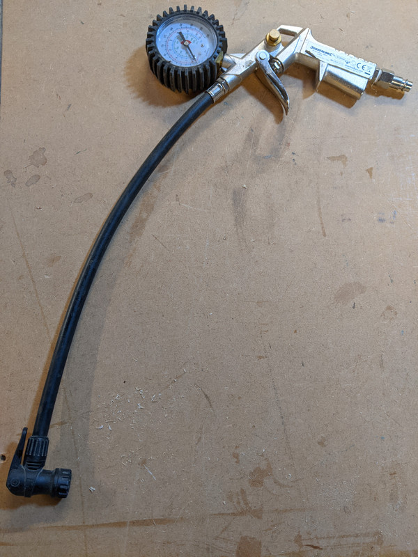

I have a cheapy compressor ( screwfix, I think) - that gets used only for inflating tubeless tyres. But the incredibly cheap and nasty tools that come with it are just that!
The tyre inflator leaks like a sieve - and annoyingly, if you get it just right, it woks like a dream. Getting it positioned just right can be a PITA.
Does anyone have any recommendations of an upgrade - Amazon /Ebay seems full of ones around 12-15 GBP that look similar. Then there is a big jump up to the ones that look like the air lines in petrol stations - but the start at 50 GBP.
Do I buy a 12 quid one and wait until it breaks , or buy something better?
Any experiences?

^ it does get used for motorbikes / cars occasionally - so I usually use a presta adaptor

When I had access to compressed air system in my old job, I used one of these below, with the wee conical rubber end - fits perfectly into Presta fitting when valve is removed.

I'm just using a cheapie, but with a bike pump head attached in place of the original chuck so it'll do presta and schrader. Lovely.
pretty sure it's this one, I chose it entirely because of the colour, it matches my air hose. https://www.ebay.co.uk/itm/163371348338?epid=941910866&hash=item2609b0f172:g:1lEAAOSwj2lhhwqf

I’m just using a cheapie, but with a bike pump head attached in place of the original chuck so it’ll do presta and schrader. Lovely
Me too.
I have the generic inflator from Screwfix/Toolstation and fitted an SKS head to it that does both valve types.

Another frankenflator user here. I cut the old crap one off and fitted one from an old track pump. Much better.

Me too - cheap track pump head from Decathlon to replace the useless one that it came with

Main issue isn't doing presta (and old £2.99 for a pack of 10 does that) it's doing presta with the valve core removed.
Has anyone seen/got something other than a whole bike pump end that works?
The one I linked to above, used it for years.

I guess I can use the one I've got if I push it firmly... was more hoping for a 'clamp type' so I have free hands.

Main issue isn’t doing presta (and old £2.99 for a pack of 10 does that) it’s doing presta with the valve core removed.
The hose itself (with the chuck cut off) should press down for a perfect fit on a presta valve with core removed, but it should also be possible to force a presta chuck on to a presta valve with core removed.
