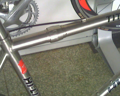

popped into the local shop this morning, and whilst browsing came across this;
It has 2 screw like thingies, so that the frame can be taken apart and placed into a suitcase. This particular bike had 700c wheels, V brakes and was made up like a tourer. Quite nice really.
The screw thingies are made in the USA and then imported into China.
