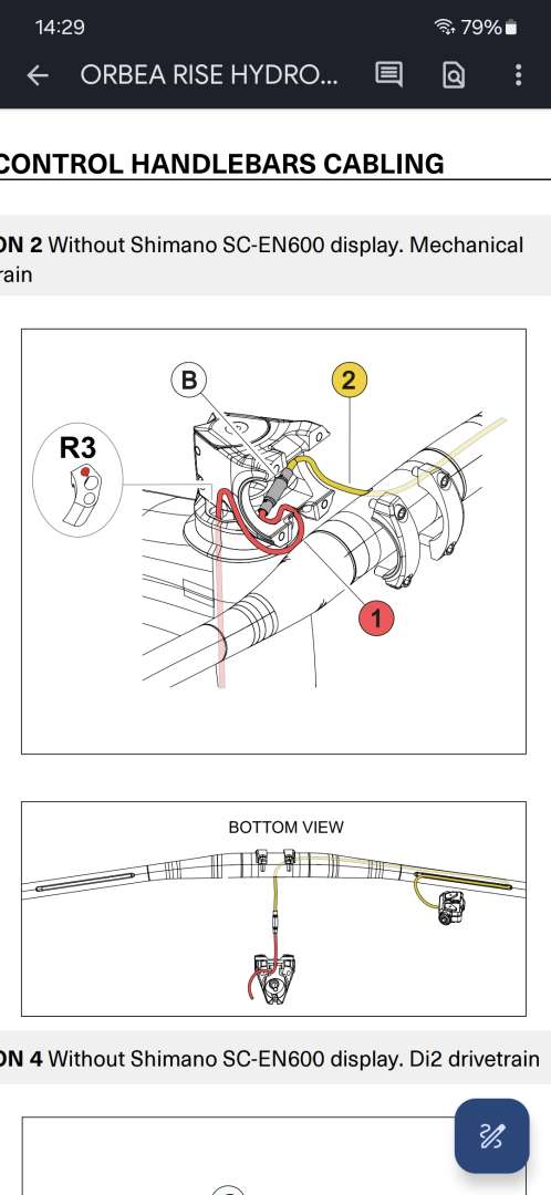

Has anyone changed the bars and/or stem on a bike with headset cable routing?
I have a Rise H10 LT on order and was hoping to swap over my carbon Deity bars and UniteCo stem, so have asked the shop to fit the Orbea "universal collector" (ICR headset cover with no spin block that allows you to use your own stem) when building the bike, but as I impatiently await the bikes arrival it's dawned on me that the cable for the Shimano E600 motor controller is routed through the stem into a hole in the clamp area of the bars then out another hole near the grip end.
As such, if I do decide fit my own bars and stem I'll need to route the cable externally and zip tie or tape it to the bars or dropper cable... which will look a bit shit and negate the whole point of ICR. We can all agree it's an awful invention that causes more problems than it solves, but at least it looks nice and neat.
For an easier life I could just stick with stock parts and leave the good stuff on my Roscoe when it comes to selling it, but I'm asking in hope that someone smarter than me has come up with a tidy solution that doesn't involve spending £150 on carbon OneUp, Orbea or PRO "ebike specific" bars with the cable holes pre drilled.

The more I look into this the more I think the best option is to just leave the stock stem on it and pony up for the OneUp or e13 carbon bars with the cable routing holes. At least with the stock stem there's the hole for the controller cable and space behind the bars for the little junction box.

Looks like there's space for the connector on the 2025 model.

that’s interesting. I was working on a 2025 bike and couldn’t seem to  get it to fit without being crushed by the bar. Though I had thought that’s where it should have gone.
this was a short Orbea stem though.  I wonder if it’s only an issue with the shortest one. And the Orbea bar hole was definitely big enough for it to go inside.

Ah, it could be dependent on stem length although I would have thought they'd cover that in the manual as its pretty damn comprehensive! There's no mention on what size frame comes with what size stem but I did notice that in the section with Di2 wiring but no EN600 display it actually shows a 4 port connector inside the stem. If the EN600 display is used then there's no connector required as that has all the ports. I'm fine without the display though, happy to use my phone for stats and have less on the bars. I stop and take photos every 5 minutes anyway 😀
I emailed OneUp to see how big the cable hole is in the center of their bars and its 10x6mm so that will be big enough to fit the Shimano connector in. Its also positioned on the base meaning I can route the cable directly from the headset port and ultimately still use my UniteCo stem. I'll probably need to pack in some foam to stop it rattling.
Also got an email from the shop today to say the flat headset cover thing has now arrived with customs from Orbea in Spain so hopefully it won't be too much longer until the bike is with me.

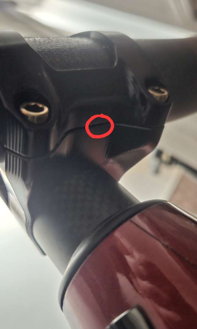

Plan semi scuppered... had to move my bike earlier so looked under the stem and both the body(?) and the faceplate fully enclose the bars at the bottom, so no space to run a cable.
I could theoretically Dremel a small notch, or I could look for something with a machined gap on the bottom. The Title ST1 and Oak Components Eternal both look like they'd have space, and are suitably angular (I don't like stems that look like they're made from two tubes, a la Race Face. Don't ask, it's some kind of weird OCD).
Posted : 13/01/2026 5:02 pm

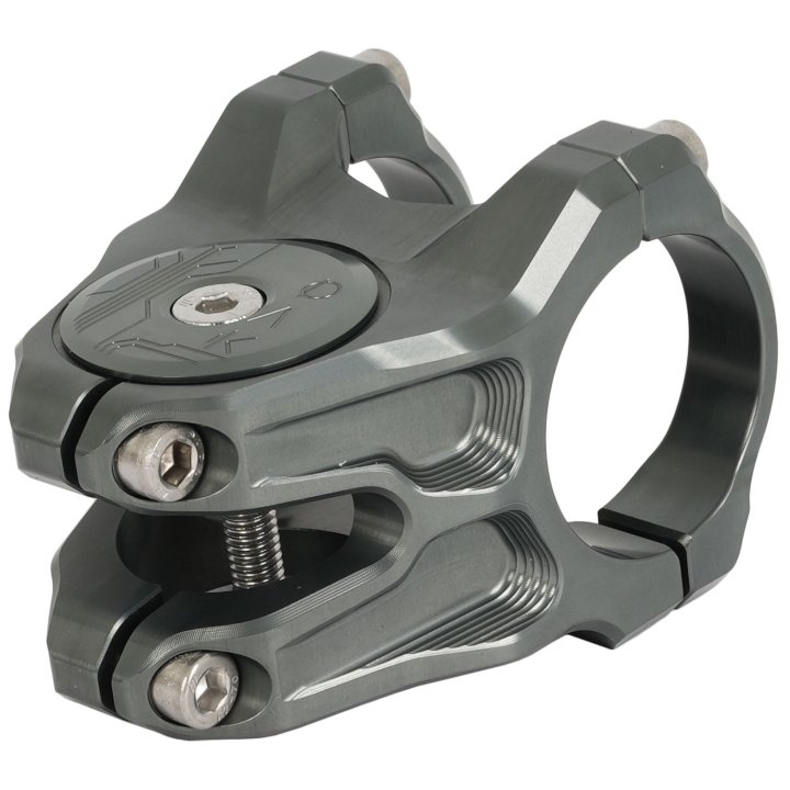

I've seen a Title in the flesh, and Oak have confirmed there's space for a cable via email.

ST1 is Silver and in use anyway
Oak is Lunar Grey unfortunately (35mm x 42mm)

It's a strange colour to photograph - doesn't really look like that pic above and doesn't really look like the photos on the Oak website, probably somewhere in-between. I'll try and get a realistic shot at the weekend.
I like it, just didn't go with my Gusset MJ bars.
Cykel House often have stock
*Edit, found this - have the silver bolts too

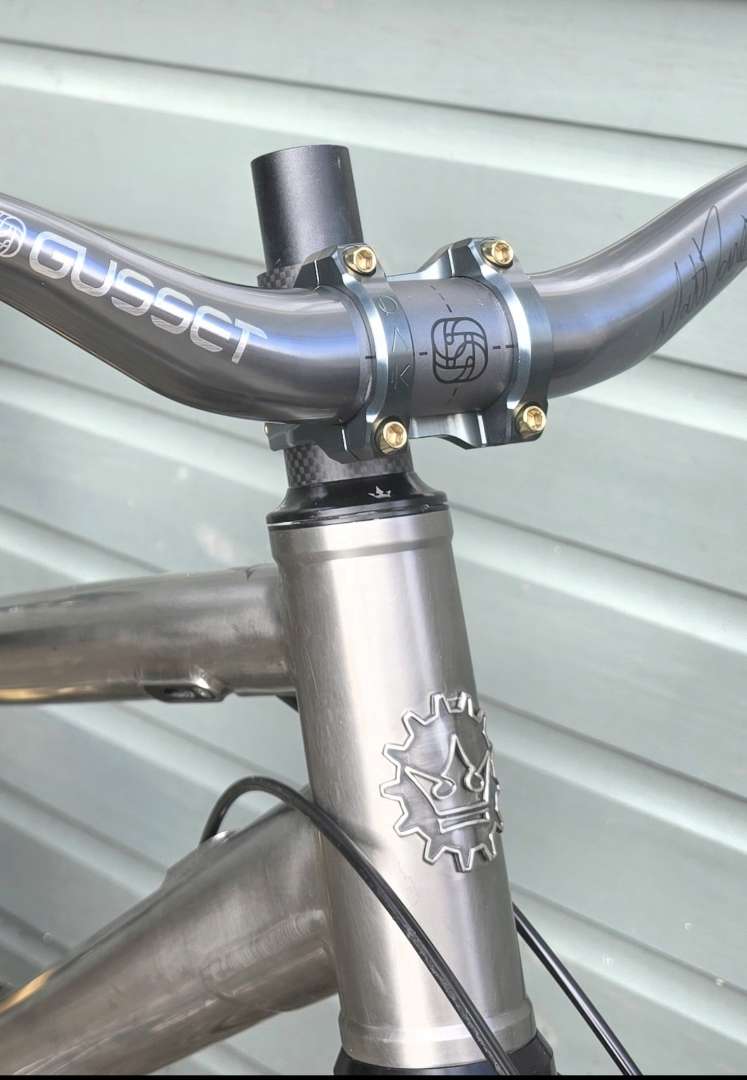

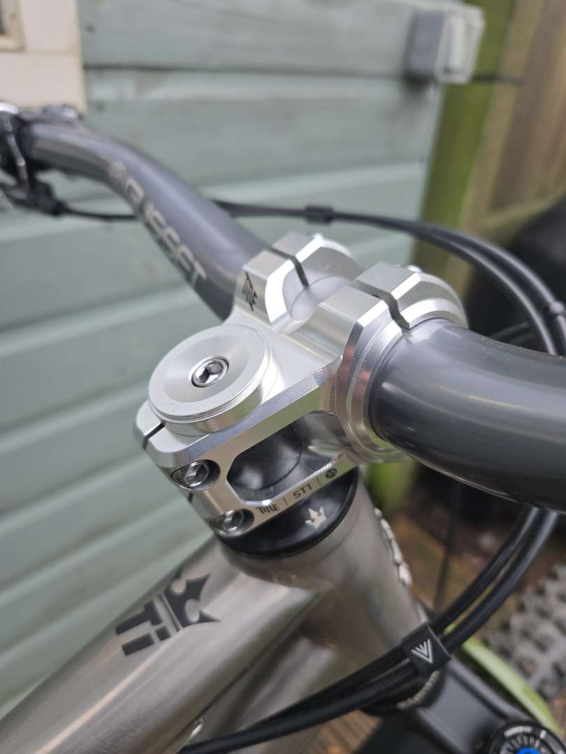

It's definitely a thing of beauty 😍
Would that colour go with this though?
Not my image by the way, I would have slammed the seatpost and had the tyre logos at 12 o'clock 😆
I think it's more gold in natural light.

Hmmm, probably/definitely not methinks. Would end up being a contender for one of the aesthetics threads 🤣

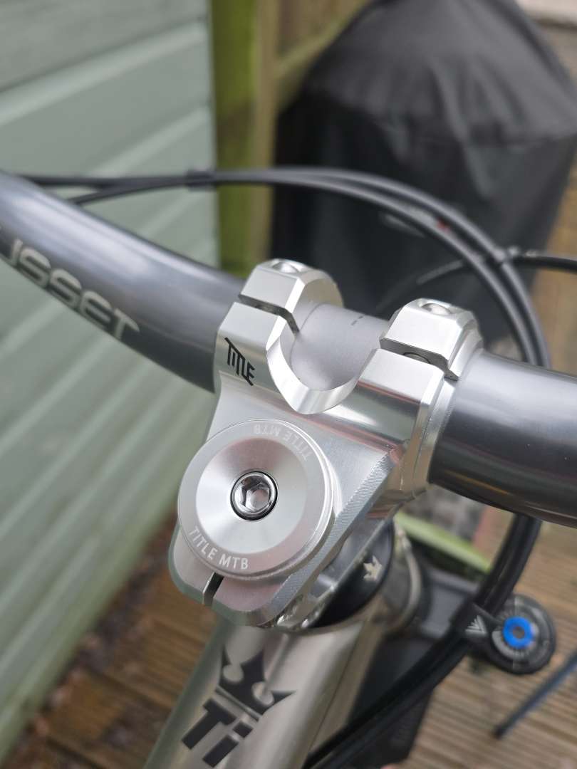

@citizenlee of the two I prefer the Title - it's chunkier.
Pics today as I got a new title top cap

That's looks awesome! Where did you get the stem from? Alan's?

No mate, Slam69
Top cap from Wheelie Bike Shop

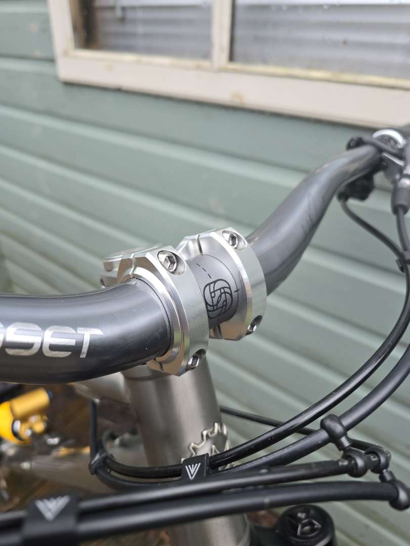

Before I drop 100 bones on a stem, I'm still tempted to Dremel a little notch for the cables on my UniteCo.
The V2 has this area machined out, and the faceplate is two separate parts. We're only talking around 2 or 3mm removed from each side with the Dremel, so should be OK.
