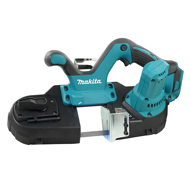

Pah, you lot are amateurs - I've just bought one of these:
Posted : 13/04/2017 12:44 pm
Posts: 39916
Fly as **** that
Posted : 13/04/2017 12:55 pm
