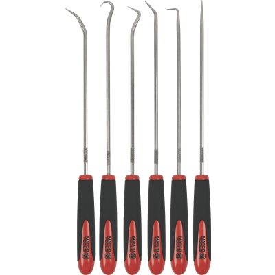

Not specifically bearing removal but I saw a set of picks like this in Aldi the other day,
When I was a full time mechanic I used to use these all the time for various jobs. Perfect for carefully unsealing cartridge bearings to pack with grease.
