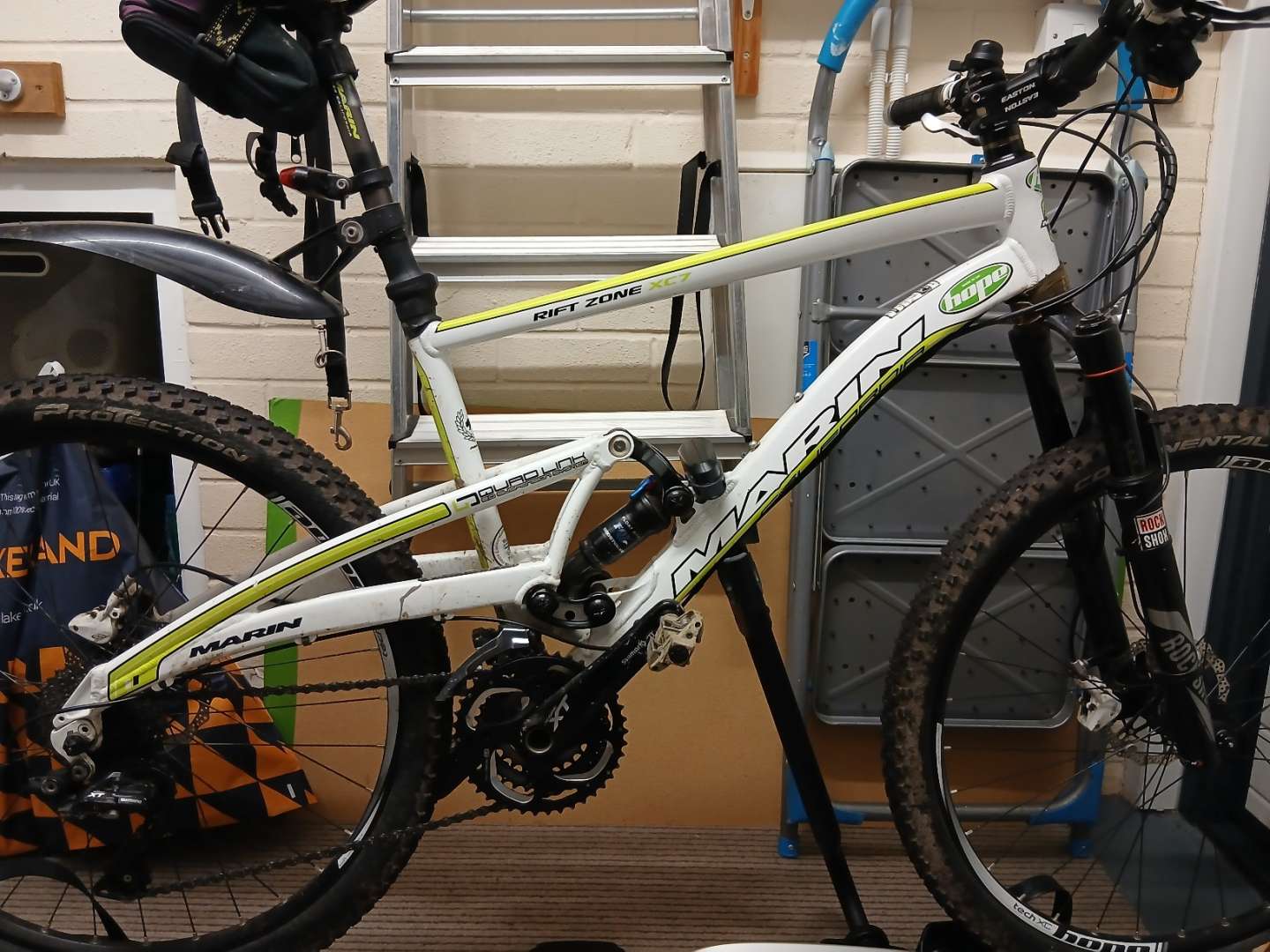

Help please. I'm looking for a roof carrier that's not a Thule Freeride or Proride. Both of those need the business end of the clamp arm to be positioned at or v near the bottom bracket area. And on my RiftZone, there's a lot of shock mounting brackets, triple ring etc around there, as per picture, which means the clamp won't work there. Positioning it higher up the downtube just means the angle is all wrong and it doesn't get a proper grip.
What decent alternatives are there? (Apart from 'buy a new bike, grandad', which seems a bit of an expensive solution) Budget perhaps £150 tops, ideally.

I don't understand why the Thule Freeride won't work ..
https://winstanleysbikes.co.uk/thule-freeride-upright-roof-mounted-bike-rack
It clamps from the sides (rather than having top/bottom 'jaws'), so looks like it would grip your downtube lower down?

The clamp nechanism was OK, but the detail I didnt go into with the Freeride was that the front wheel then extended a bit too far beyond the furthest possible position of the front cradle in the runners, even with the unfashionably steep headtube & fork angle. Basically it was only half in the cradle, which just didn't feel sensible. And you can't slide the clamp arm backwards or forwards, as it's riveted in place on the runners.

How much space has the frame got just above the bottom bracket? I had a Mount Vision and that was where I clamped my bike...worked a charm as was a solid connection.
Your picture shows a similar gap.

FWIW the proride works on mine, and that bike has loads of hardware there as well. Double not triple though.
Have driven hundreds of KM with no issues.

As far as I could see, not enough to wheedle the side clamp of a Freeride into (perhaps because of the triple rings) or poke the business end of a Proride through. I did try both, honest I did.

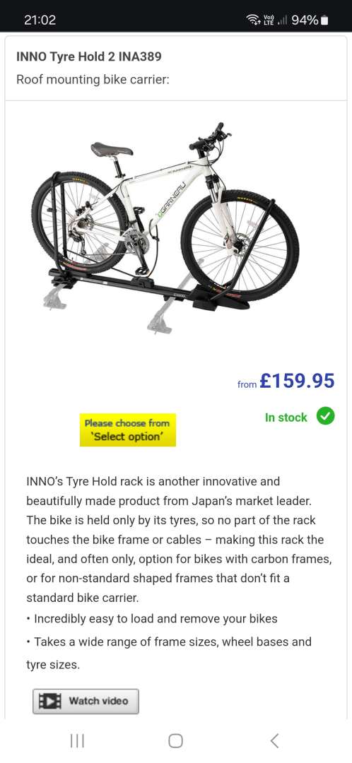

At the moment, I'm looking favourably at one of the options on roofbox.co.uk which has a U-shaped tube holding both front  and rear wheels. That looks a lot more secure than just the front wheel, although I guess those are bombproof in reality. Just me being nervous, I suppose.

Have gone for one of these after a bit of havering
The type that clamps the forks after removing the front wheel?
No doubt they're fine, but to me, the higher up that the mechanism holds the bike, the securerer, or something
