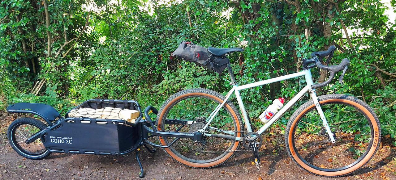

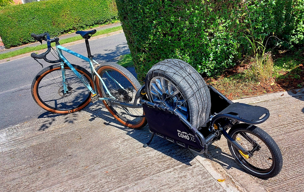

I thought I'd update the thread in case anyone was interested.
I ended up with a Burley Coho XC over the Bob Yak, and I'm very glad that I did, for three reasons - the one handed quick release, the kickstand, and the suspension
Get to the shops but the bike parking bit is too small for bike+trailer? Unhitch and lock them side by side. Want to load the trailer whether the bike is hitched or not? Use the kickstand. Going over potholes and dirt tracks? Suspension.
It's a great bit of kit. Well made and versatile. I've had it fully laden with timber at 35MPH with no speed wobble.
I'm also glad I went for a one wheeled format, as I can go around tighter bends without it catching.
Posted : 26/07/2021 8:56 pm

Quite expensive trailer all the same, though considerably better priced that thew bob yak
Tell me about it! Basically if you want this at a good price, you need to live in the EU. Bob Yak is unavailable in the UK full stop, and the Bob Ibis is crazy money. And unavailable.
Anyway, how are you supposed to stop and take an insta-worthy pic without a kickstand?? Win win with the Burley 😉
