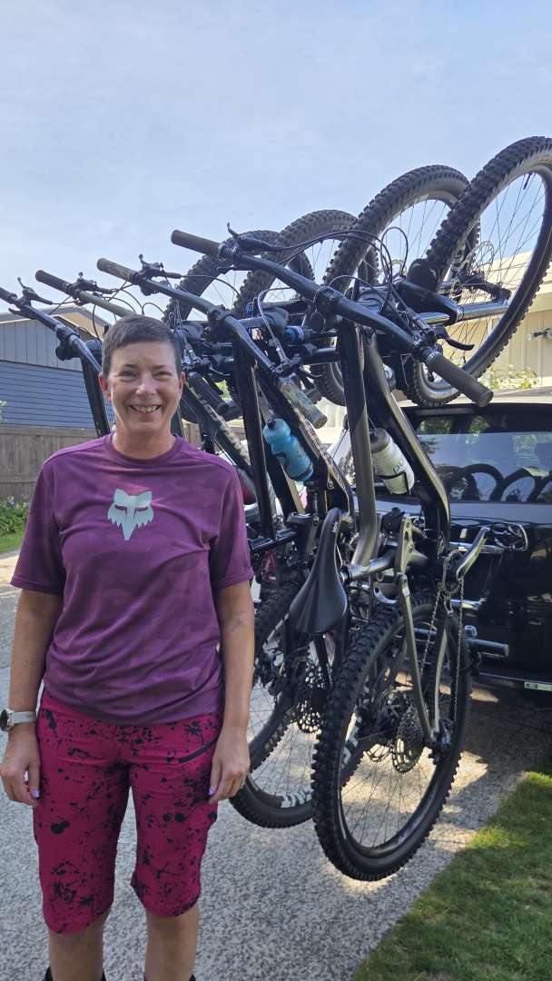

Had a van for quite some time so our Thule which has been first class has been gathering dust at the back of the garage just in case.
Been using a vertical one ou in NZ for the last 11 days and I'm a convert. Can't understand why we dont see them in the UK. Quick and easy to load and very stable
Posted : 19/01/2026 4:54 am
Posts: 7475
@Tracey I assume it's mainly because there aren't many 2-inch hitch receivers on UK/EU vehicles. Plus, you need to be a bit careful about the weight on the hitch - people often assume that if you can tow x tonne then you can load a certain proportion of that from above, but if you look at the detail a lot of vehicles aren't supposed to carry the weight. eg - at 15kg a bike, plus the weight of the rack you could be up to 100kg. Add on the impact of leverage from the overhang and you're probably past the average UK family car's limit (eg a Ford Focus is apparently 90kg)
We've got a vertical rack here in Oz on our main car and it's so easy to use I wouldn't even consider anything else.
Posted : 19/01/2026 5:09 am
