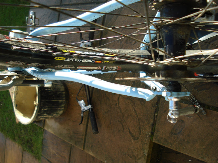

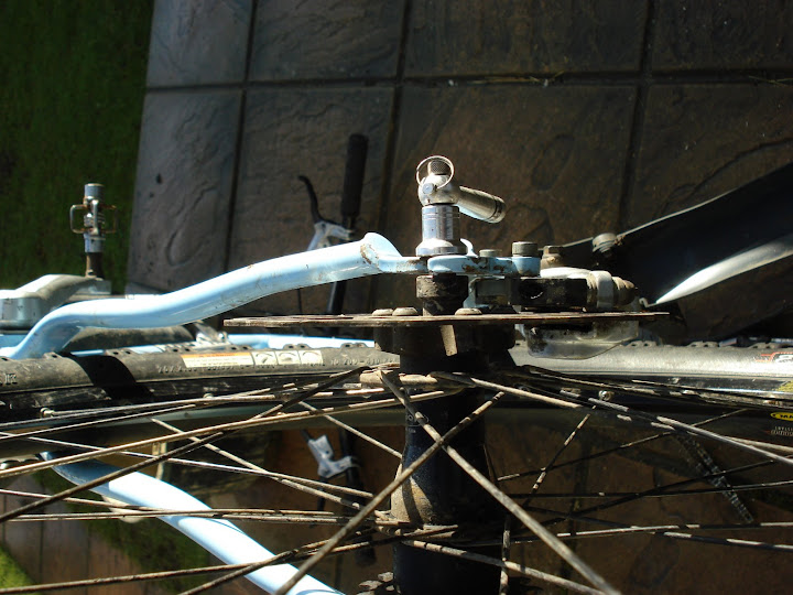

Posts: 405
It looks like this
And with the wheel the other way round

Have you tried it with a different wheel? Maybe the wheel spindle is bent..
Yup I've heard bob jacksons is good, should be able to do it, if not any car place with laser chassis alignment might well have a good go. With inbreds being pretty cheap and all, I could see you spending nearly as much as a new frame, I'd be tempted to get a big scaffold bar and have a go myself..

It is definately the frame not the wheel.
The drop outs are square to one another, its just the whole lot is shifted. So i am not sure that Park Tool kit will work (it seems to say it really is for drop out misalignment.
Its not worth spending a lot of money as they aren't expensive

Posts: 41395
Your wheel looks out of dish. Am always amazed that a frame can be bent in this way.
Posted : 18/01/2010 11:08 am
Posts: 405
The wheel isn't perfect, but the wheel from my other bike that is perfect sits the same.

Posts: 41395
I'm confuzzled.
It looks as if one of the chainstays has effectively lengthened or shortened, in order to make the wheel sit squint. It's not that the spacing has changed or that the rear triangle has twisted out of alingment with the front.
Or am I crazy?
