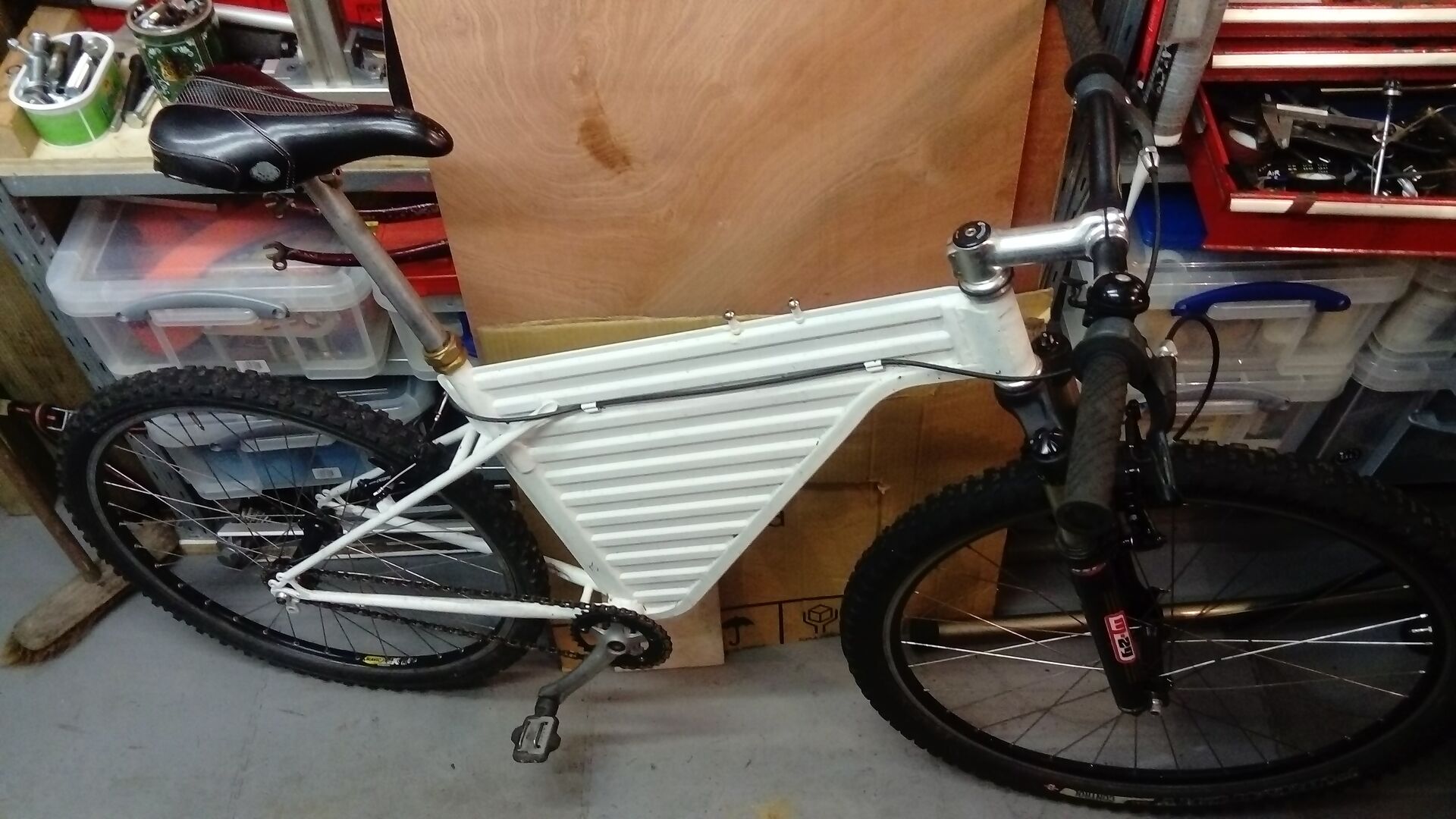

But then all of this goes out of the window when you make a bike from a radiator and it rides surprisingly well 🙂
