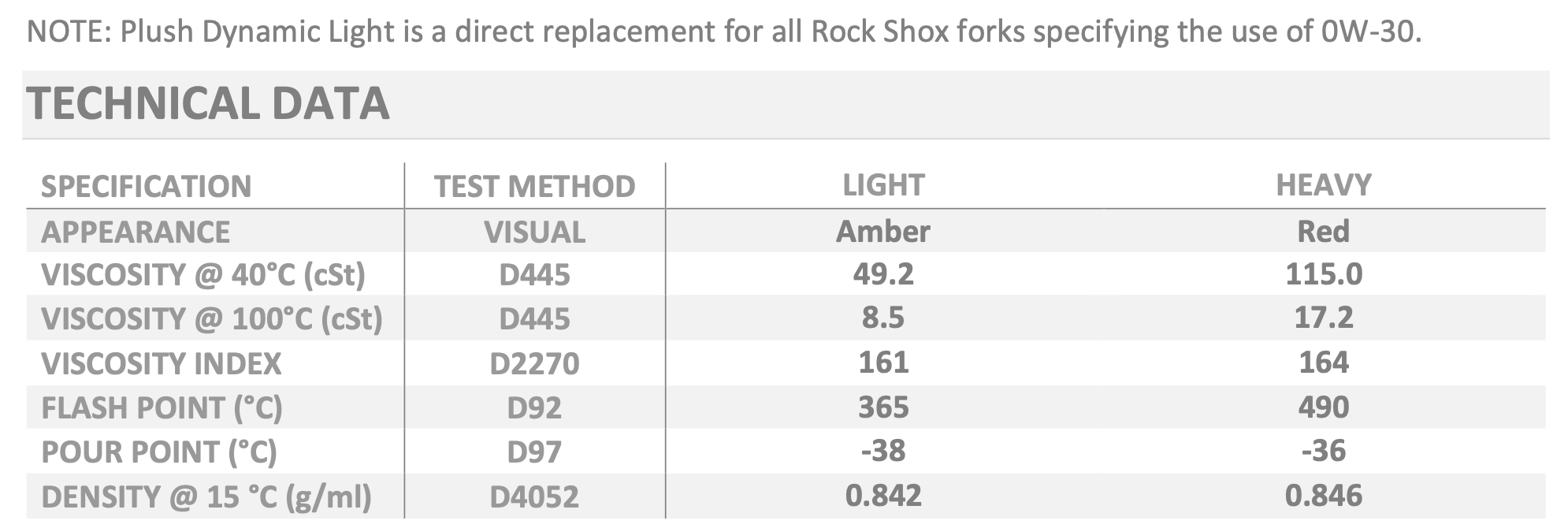

I managed to find the SAE grade for the Plush Light oil, but not the Heavy variant - any ideas?
Posted : 12/06/2025 3:08 pm
 Oms
Posts: 265
For context. The Maxima Plush oil specs (for light and heavy variants):
Posted : 12/06/2025 3:45 pm
Posts: 793
Posted by: Oms
Interesting data.
The light variant viscosities would indicate it's close to a 0w-20 engine oil. Castrol and a few other brands oil of that grade appear to fit quite well.
A 46 grade slideway oil would also sit fairly close.
