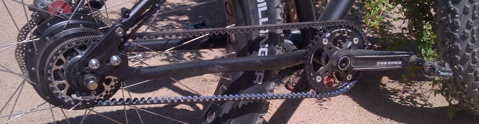

9:Zero:7 with a NuVinci and 42:28, spins out at 20-25km/hr
No chain.
