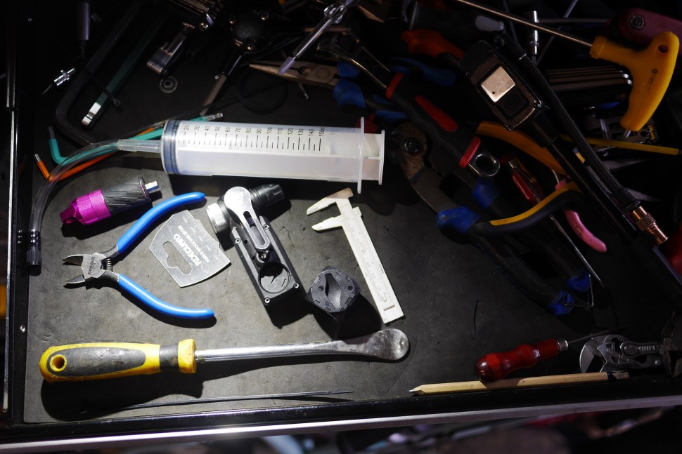

Perhaps none of these are essential but they are all items you will never regret buying (apart from one)

I’ve got the Wera Allen keys above and on first look they seem great. What they do leave me wishing for is the longer end not being a ball type Allen key. Maybe I just need another set essentially the same but with normal ends on as it would be useful to have both…… That Pedros metal tyre never would make me nervous - I find the cushcore bead dropper gets pretty much any tyre on without scratching rims. I find it especially helpful when fighting with a tyre with an insert in it.

Syringes are undoubtedly useful for tyre gunk and brake fluid, but it's worth saying that buying a 'bike specific' one is just asking to pay over the odds. You can get a 150ml syringe + length of tubing for less than a fiver on eBay, for example.

IHN - true ish. It's the threaded end that goes on to the valve and makes everything more secure (especially when there's resistance in the valve) that's worth it in my opinion.
Posted : 11/11/2025 11:21 am
Yep, and I use some mini-snippers from a £6 pack of three pliers & snippers that Lidl do a few times a year (vs. the £25 Park ones)
The DH tyre lever (think mine is X-Tools) recommendation is spot on though, mine has helped me get the better of many a stubborn tyre/rim combo.

Oh, the ironing, if the Wera allen keys went in the holder easier, I'd use them more...

I can't disagree more about the Wera's. I've had my set for years and they're still going strong, I've also never needed more insertion depth even for thru axles
No fricken way is a metal tyre lever going anywhere near any of my rims. I can get most stubborn tyres on with normal pedro plastic tyre levers and the, as per Joe the cushcore bead dropper does the rest. Just bought one of those Tyre monkey lever to see if it make it easier.
Have the wera set allen key, but I still tend to use an my Halford professional range more

Posted by: dc1988
Posted by: Ben_Haworth
Fair enough, I'm a whip the thing out, slip in my length and empty my load kinda guy.

Most used tool in my tool box - Knippex plier wrench.
Gets used on the bike, on the car, round the house, lent to FiL (I trust him!), used in work, taken on holiday. Best and most versatile tool I've ever owned.

I have one of those fork cap tools on order from Halfords (20% off Park Tool just now) as a luxury tool to replace my usual bit of inner tube over some pliers. Also ordered the (way overpriced so it had better be a joy to use) wheel holder WH-1
Wera hex keys I also find good but occasionally irritating. I’m not convinced their special shape is ideal on aluminium fasteners and the plastic sheath can make them useless if access is tight e.g. recessed grub screws. They do loads of options though, I just bought the wrong option

For those in fear of damaging their rims, the IceToolz DH tyre lever is nylon coated.
Agreed. One of mine has rounded and buggered a thru axle.

A set of decent nail clippers is the GOAT for snipping cable ties. The rounded profile means you don't get any pointy bits and they cost a couple of quid.

Also the best tool I have for resetting brake pistons. Parallel action and smooth jaws work better than any other of the various tools I've tried over the years.
I've also got a Stans branded sealant syringe same as that one. I've actually blocked the nozzle/tube up with the squirting action a couple of times when using really good sealant, I tend to just use it as a funnel now and it works that way too.

Being new to tubeless, I found a syringe invaluable - use the tube with the long needle spout.
I don't like the idea of tipping fluid in and then trying to get the rest of the tyre on the rim

For anyone looking for the Vittoria tool, this might be worth a look. Doesn't specifically state it's the MTB version although that's what's pictured (the box at least has 'MTB' on it) and no mention of the 6 tyre lever things. £12.99 vs the ~£25ish it is most other places: https://www.decathlon.co.uk/p/pliers-and-tyre-lever/_/R-p-X8910022

I (re)use the little bottle of Stans. It fits into the top of the stans tubeless valves, and is about the right amount. Just pop my finger over the end when I'm tipping it up

Never found an issue with Wera hex or Torx wrenches.  Use the ball end for low-torque just spinning the bolt and then nip up with the other end and check with a torque wrench.  Not rounded a bolt head or wrench in the 5 years I have been using Wera wrenches.  Have to admit I am mechanically sympathetic and look after tools.
Nail clippers as mentioned above are great for cutting zip-ties.
Tyre fitting tools have moved on so much since I have been riding.  The Vittoria tool and a Tyre Glide have made a great difference - especially with tyre liners and poor rim and tyre combinations.  My thumbs thank the inventors of these!
Chain link pliers - made joining or splitting a chain at the split link so much easier!
Cable cutters.  Nothing has beaten the old Suntour ones I lost 😭.  The Park ones are ok - but just not as good.

Most used tool in my tool box – Knippex plier wrench.
@tthew how do you do this? I can’t picture how this would work. (I’ve got a set, one of my favourite tools)

£20 quid for the Muc Off tool? Just use an Allen key bit wrapped in some gaffer tape.
Yeah Wera do both types, I have them
