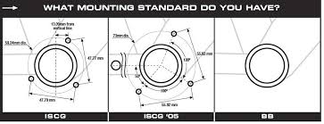

Currently putting together my new frame which can only be used with a single ring up front (Kona Honzo).
I've bought a cheapy Superstar BB mounted chain device (£16.99) but before the chain is actually on the bike it already looks ugly and doesn't seem to sit right to me. The full Honzo's come with an E13 LS1 device that also has a bottom roller but they are pretty expensive and i'm confused over OLD ISCG and '05 ISCG options when i look on CRC etc. I have ISCG tabs but don't know if they are all standard?
Originally i just wanted a single ring and bashguard (simply because i prefer the look compared to ring on its own).
So.... Could i just use a bashguard and then one of the Ngear Jumpstops which are both cheaper and far less bulky?
My mate runs 1x9/10 without any type of chain device but the consensus on here seems to be you need something up front to keep the chain on.
Any info gratefully received, Cheers.

Cheers guys.
SSSimon - any chance of a link to that diagram as i can't read the numbers when i enlarge the screen.
tk46hal - that reassures me a bit, cheers, i was just a bit confused as the other chain devices seem to have a cage that follows the contour of the chainring but the SS one seemed too far away at the 'thin' end of the cage. I'm guessing in practise it works fine though and isn't too noisy?
