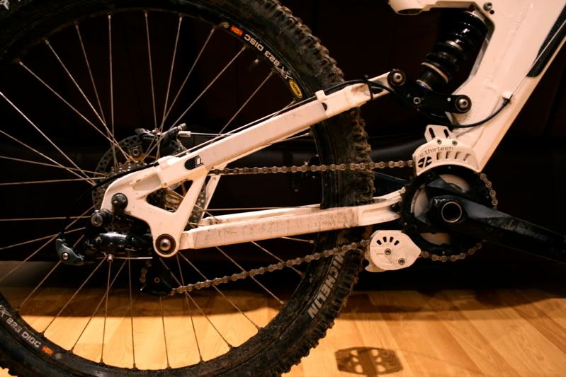

[img] http://images.fotopic.net/?id=62919100&noresize=1 [/img]
Gamut chain device, 36T ring with the chain line dead straight to the 17T sprocket at the back, which is the ratio I run on my singlespeed, hence the one I expect to use most.
