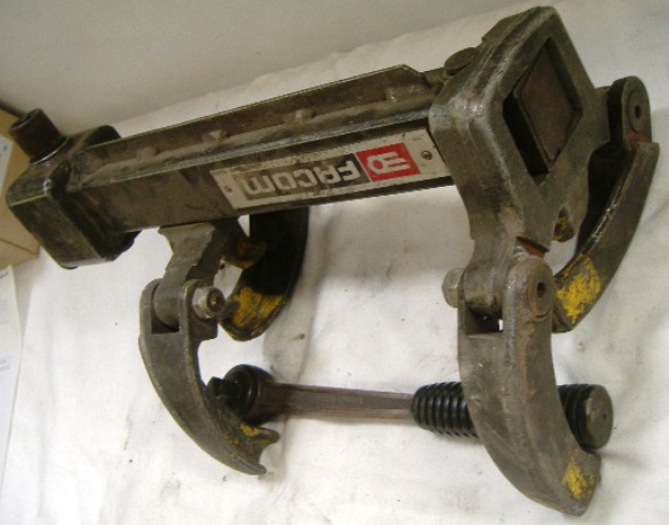

Hopefully be able to pick up some spring compressors from a mate in the pub tonight
Stoner, if you were local you could have borrowed mine, the mother of all spring compressors.
Posted : 08/08/2013 8:03 pm
The old spring looks a little thinner diameter wire, so probably lower rate, and quite possibly sit lower loaded. Rate goes to 4th power of wire diameter, so it has a big effect.
Hard to count coils on old spring. ~7.5 coils - could be V8 RR/Disco front springs, 7.75 coils could be standard 90 fronts. Both lower rates.
Should sit up well on those HD ones, although maybe a little firm/harsh without extra weight up front, eg winch.

bloody hell mcmoonter!
My mate is as reliable as a landrover....so Im going to have ago with some ratchet straps and judicious jacking this weekend. I only need 9 fingers, dont I?
Posted : 08/08/2013 10:16 pm
Posts: 8239
I've never replaced a coil souring in a Land Rover but I would where ever possible use a prescribed tool.
I head a horror story where a Rolls Royce mechanic replaced the front coil on a Shadow. The springs have to be compressed to about a half of their length. They start out about three feet long. One can either use the RR tool or a couple of lengths of threaded rod on top of the spring mount to compress it. He used the rod method. It worked fine on one side, but he reused the same rod on the other. It snapped, the spring ejected and ripped off half of his face.
Posted : 08/08/2013 10:25 pm
Never need spring compressors when changing LR springs, even long ones, and those new ones aren't very long, shorter free length than the old ones. With the chassis jacked up allow the axle to droop, add a little weight if required and the springs should go in fine, a little boot can help 😉 Just watch the brake lines, this is where slotting the holes in the line mounting brackets help as caliper/lines can be moved without undoing anything that will drop fluid.
Edit: Put the top of the spring in to the chassis seat first, before slipping (or booting) the bottom on to the axle spring seat.

cheers Mark,
thats much what a landy-nut mate said this evening in the pub. He suggested removing the callipers to keep the lines free.
Bit of leaning on the chassis/crowbar and it should go in easy enough.
