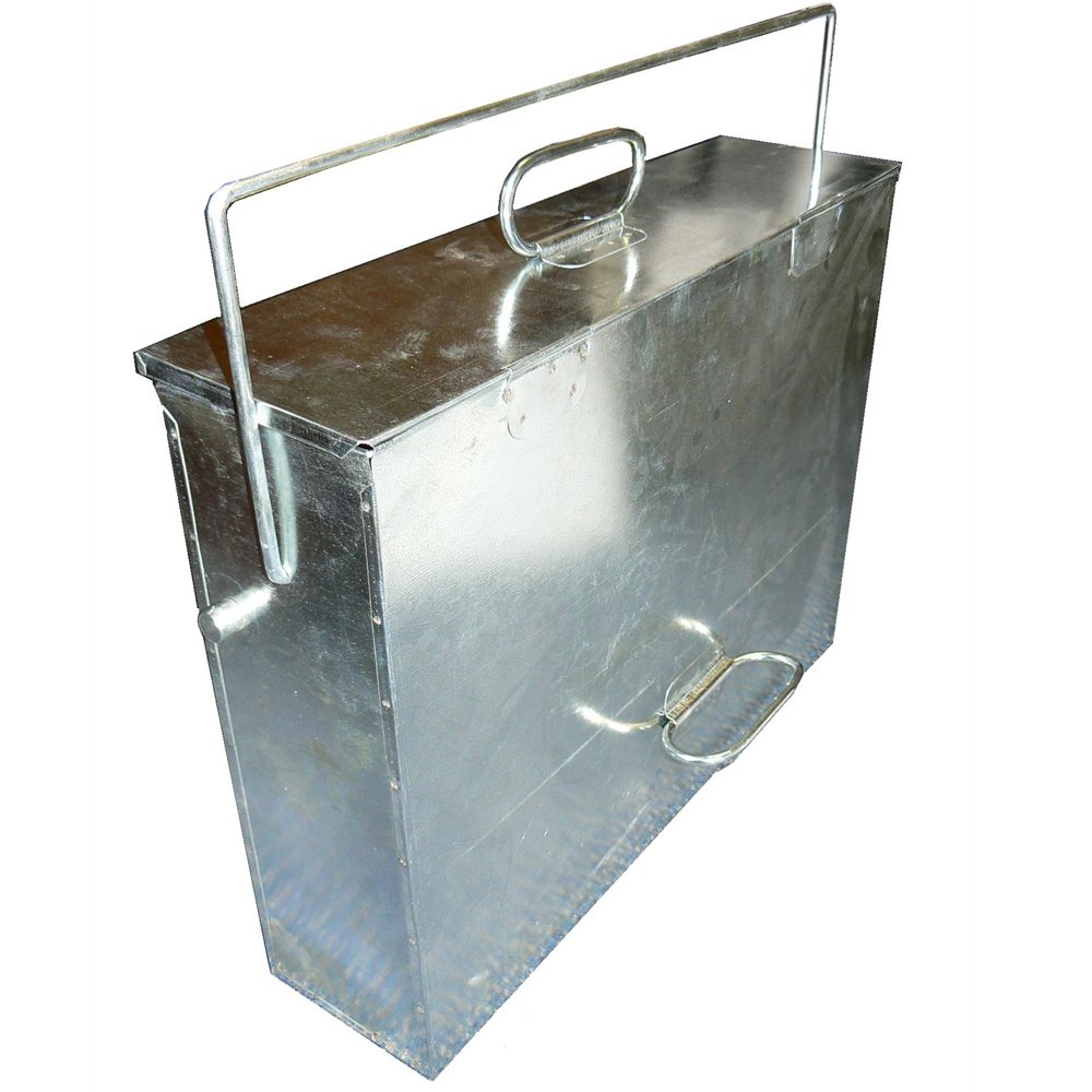

What's all this about getting a faceful of dust?
Just use a tipper box:
