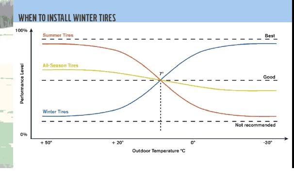

All tyres should be like winter tyres all year round but they would wear out too fast so standard tyres are a compromise between grip and durability.
I don't entirely agree with that, my experience of winter tyres in warmer weather is that they are too flexible and the car becomes unstable in emergency lane change manouvers that wouldn't unsettle it on summer tyres.
My wife had a crash on the dual carrige way when a truck pulled out of a lay-by without spotting her and she had to emergency brake and change lanes to miss it. The car went into momentum oversteer and after 2 or 3 good attempts to catch it she finally lost it and we parked rear first into the central barrier (I was in the passenger seat). Nothing serious in the end, no-one hurt and didn't hit any other cars but it was a pretty big one and could have been properly messy. This was as the weather was begining to warm up again in the spring and the car was still on winter tyres. I've driven the car (a Forester) on the winters and on normal tyres and that instability is only there on winter tyres in warmer weather. I've noted the same thing with both of my last two cars, as the weather warms up they start to feel nasty on winter tyres in a way that they didn't in the cold weather. It's how I know it's time to swap the tyres on my car (a BM 530d FWIW), it starts to want to swap ends very easily on the summers as it gets cold and then again on the winers as it gets warm.
Obviously your experiences may vary dependent on the cars and tyres concerned.
Posted : 12/12/2012 12:36 pm
Posts: 91205
How warm was it?
Posted : 12/12/2012 12:49 pm
Posts: 23391
Sounds like user error to me...
Posted : 12/12/2012 12:56 pm
Hmm, maybe 12 deg C and a slightly damp surface. It feels fine at this time of year and it feels fine on summer tyres when it's warm. I think the flexible design of the tread and soft rubber just allows the tread blocks all to shuffle and the whole thing just takes on a massive slip angle. It was a proper tank slapper too at about 60, swung to about 45 degrees each way across both lanes (no other cars around fortunately) before going all the way round and off backwards to the right. Ended up hitting the barrier fairly gently and we were able to drive it out and stop in a lay-by to swap out a bent wheel (from mounting the kerb sideways / backwards at the end) before finishing our journey. Wouldn't like to do it again, that's for sure.
Posted : 12/12/2012 12:59 pm
Posts: 23906
How warm was it?
probably overly simplified but 7 degrees tends to be the magic number
[img] http://www.e90post.com/forums/attachment.php?attachmentid=590695&stc=1&d=1318165981 [/img]
however in the UK the average temp in the sort of areas where most of the population lives only drops below 7 degrees for a few weeks each year - but how do you guess which weeks those will be, I was driving in minus temps in late august this year. Thats why we don't have legislation for winter tyres, our climate doesn't warrant it. Most winters, on most journeys on any given day you could drive in temps that are well above and well below 7 degs
Posted : 12/12/2012 1:04 pm
