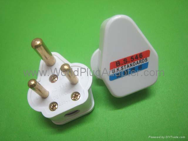

Low amperage round-pin sockets in the four corners of the lounge so that all the table lamps are controlled by one wall switch.

I also got a few plugs for floorstanding lights run off light switches - not sure what they are called but they a like small 3 pin plugs.

These are the plugs you need for the switched light circuit; they're a leftover from the pre-13A square pin days.
