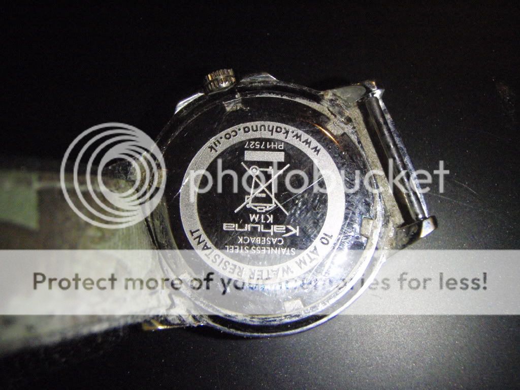

Anybody know how I get this watch back off?
It looks like it ought to unscrew, but what can I use as a bodge tool to grab those little indents?

It's exactly that, it unscrews. I've cracked them open in the past with a flatblade screwdriver and a small hammer.

Jewlers have a special key that fits the indents, turn it and the watch body comes free. Don't think I'd try and bodge a watch open, for sake of a new battery you could damage the back.

i used long nosed pliers held vertically, ends in 2 opposite indents - worked a treat

Maplin sell a tool for about £10, depends how valuable it is

Thanks - had already tried needle nosed pliers without success. Found another set with smaller ends which fitted better and job done.
