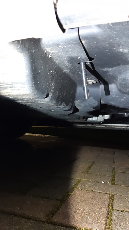

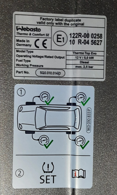

@beamers your van may already have an aux diesel heater that is used to warm up the engine faster. You can check by seeing if there is a webasto sticker in the drivers door shut or a small exhaust under the van near the fuel tank. If you you can buy a kit that allows you to use it when the engine isn't running and the heat comes out of the vents.

If you really want to spend some dosh and improve the van, one of the webasto engine pre-heaters, they warm up the whole engine block and cooling system, so the van starts smoothly and doesnt run cold
I've got one of these factory fitted in the T5.
Doesn't really heat the interior much and kills the battery.
You can set it to come on at a set time, but I never use it (irregular use and van is too far away for the remote to work).
If you use it and don't start the engine soon after you might find your batteries (motor and leisure) flat.

@Jonk and @hot_fiat I've just had a quick check and found these:
and
So, what do I need to do next to get this to blow hot air into the vehicle?
Posted : 22/09/2020 9:41 pm
 jonk
Posts: 1126
Here
If your van doesn't have climatronic there is another kit - These guys did mine mine has only manual heating
Posted : 22/09/2020 10:36 pm
Posts: 4690
Get the van scanned with VCDS. Webasto are a bugger for fitting random controllers to those heaters. VCDS will show you exactly which controller you have and then you can work out which remote you’d need. If you’re planning on having one fitted, ask for a demo first - they are slower than an air-air.
Posted : 22/09/2020 10:59 pm
