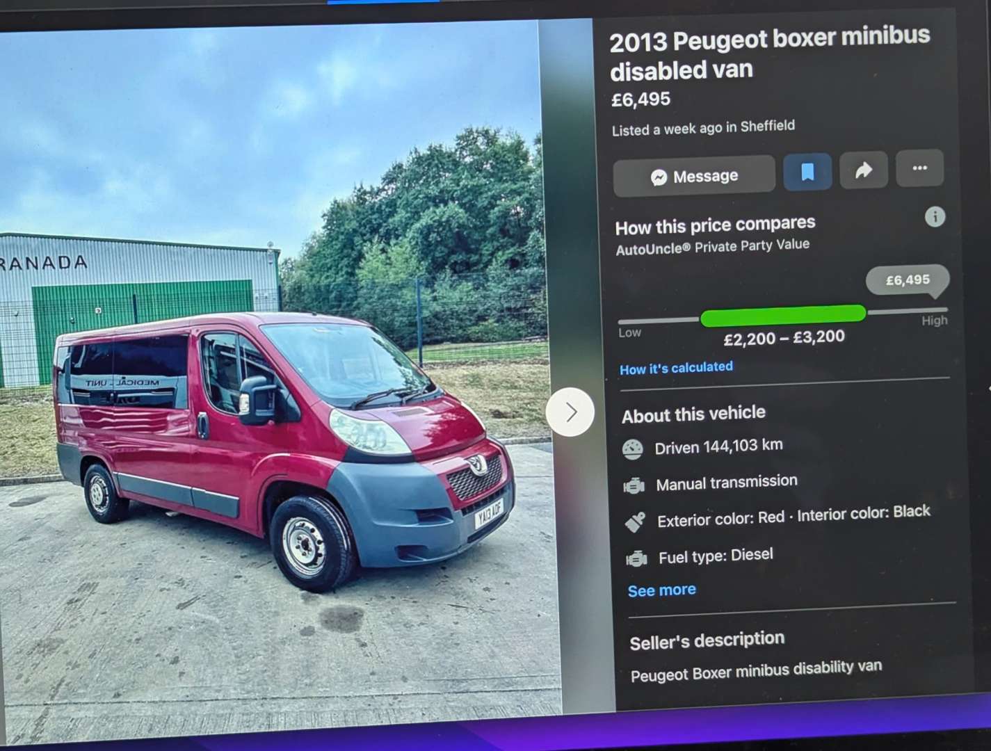

Posts: 9065
Buy this
Council wheelchair van. CAZ exempt and for sale in Sheffield.
Posted : 07/09/2025 12:07 pm
Posts: 3061
Can't see it dude
Posted : 07/09/2025 12:44 pm
Posts: 3319
Budget campers are the best campers
Posted : 07/09/2025 1:33 pm
Posts: 9065
This forum is shite.
It's this one...
I had one of these for about 18 months and I really liked it but mine was just a panel van so when the CAZ kicked in I sold it.
